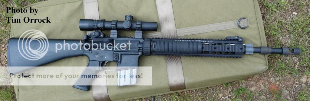

Check out the Centurion Arms SPR Sticky.
Lots of good pics of the Mk12 Mod 1 and Monty’s clones.
Here’s a pic from the thread-

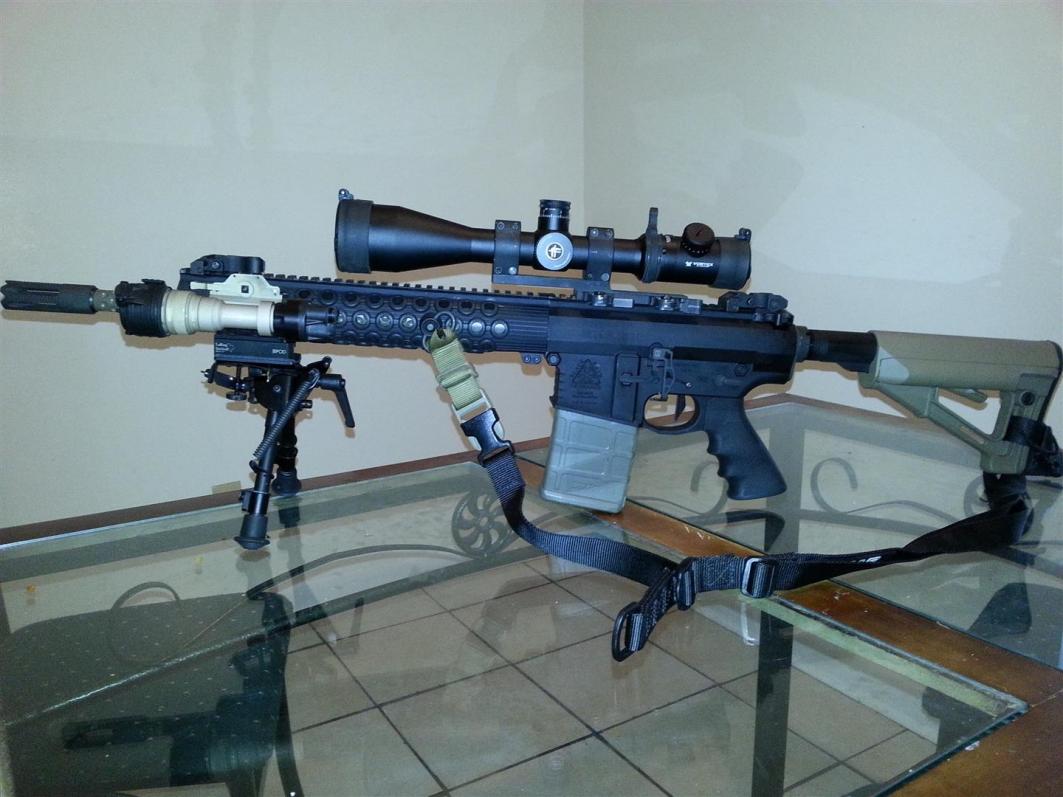

My 3gun rifle as current as of today 7/20/2009, it’s a work in progress.
18" WOA SPR 1-7 twist .223 Wylde chamber barrel turned down to .650" under the rail (courtesy of W.A.R. Rifles). JP adjustable gas block LMOS carrier and close range sight, BCM bolt, KAC Triple Tap comp, VLTOR MUR upper, DD RIS II M4A1 rail, Bobro forward grip and 30mm scope mount, Burris XTR 1-4x 30mm scope, Charles Drissel ‘cat-tail’, Troy FDE flip up sights, PRI gas buster charging handle, Tactical Innovations lower, Geissele trigger, LMT SOPMOD stock in FDE, Magpul XTM covers, MOE grip and MS2 sling and PMAGs, Arrendondo mag button. Assembled by me ‘gotm4’.

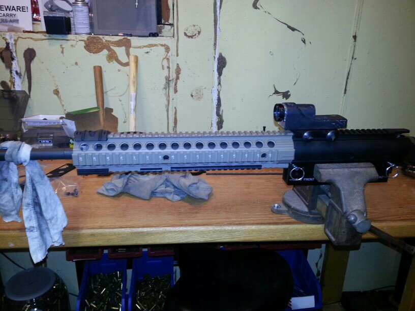

You are correct, this is a rifle length gas system with a 14" rail. Should work out just fine for me.

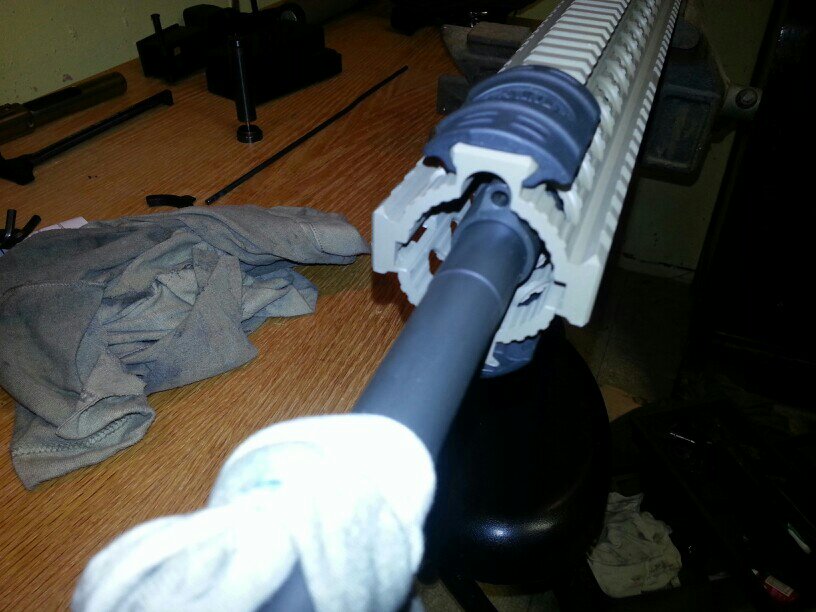

Gas block will sit back just about an inch or so from the end of the rail. I will try to find the end view. These are not my pictures, but provided from a member here on M4C. The rag is where the barrel will be cut to length.
Found it.
This is what I am working on.

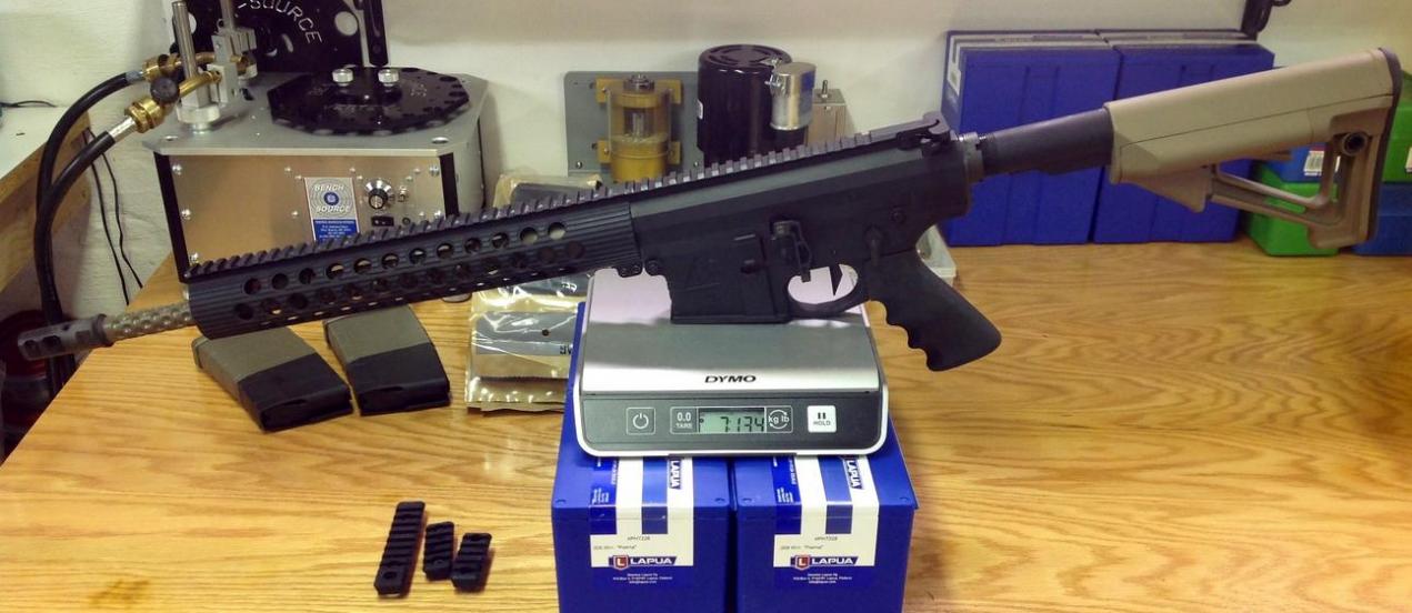

If you are set on that build, then it’s “shooters choice”. The weight if the barrel with a A2 would be close, a light hand guard will help. Depending on the eye relief of what you end up with will determine where it will sit on the upper as you may know. I know this is not what you were talking about, but this is how my SPR started out.
It’s was a 16" Rainier Amrs Ultra Match, the rest is pretty easy to see what it is. As you can see the weight is low and pretty much centered. If I was to throw a RDS on it on the upper it would still stay low on weight and weight front to back would be the same. A little weight forward will help for actual shooting. There are several different views on this but it get’s back to what I call shooters choice. Everyone is different, bottom line.
