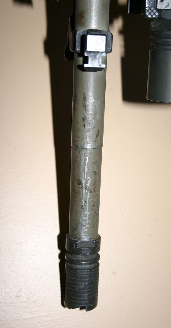

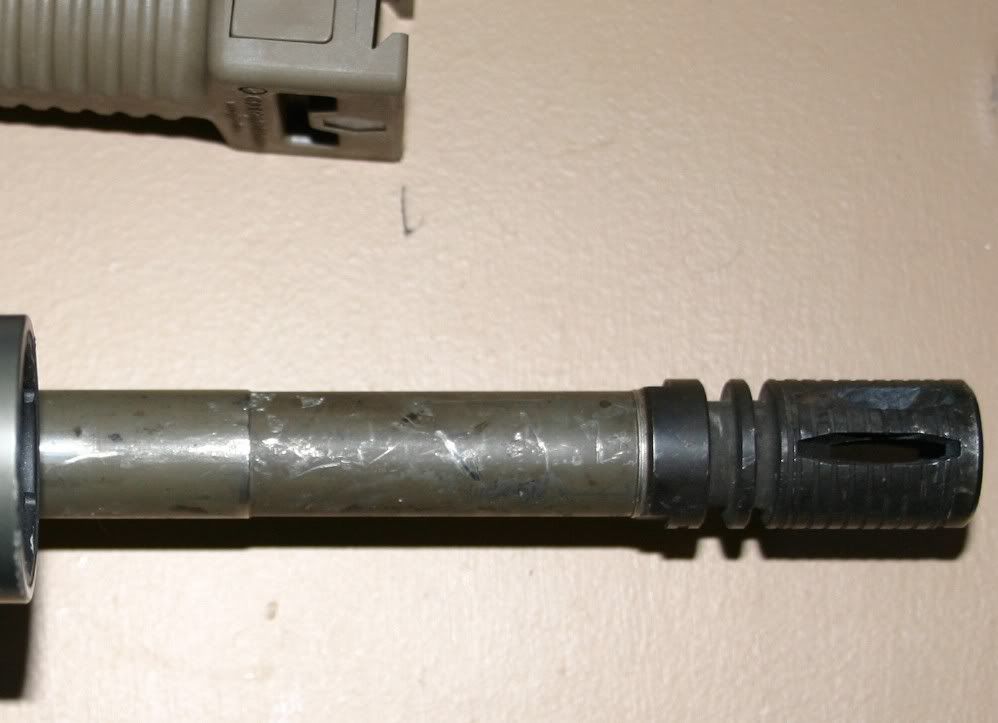

I have KG on a Douglas Barrel –
I’m not a science type and so I would defer to TWL - I have not noticed any problems with it - only issues with the damage to it due to harsh use.
that is the exact barrel i was thinking of and i would never paint a six hundred+ dollar barrel but id sure love to have one:D
