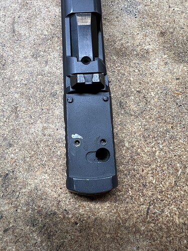

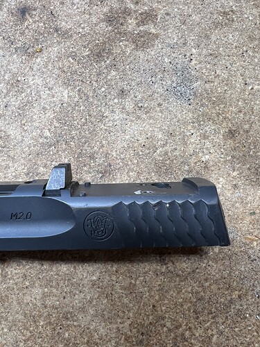

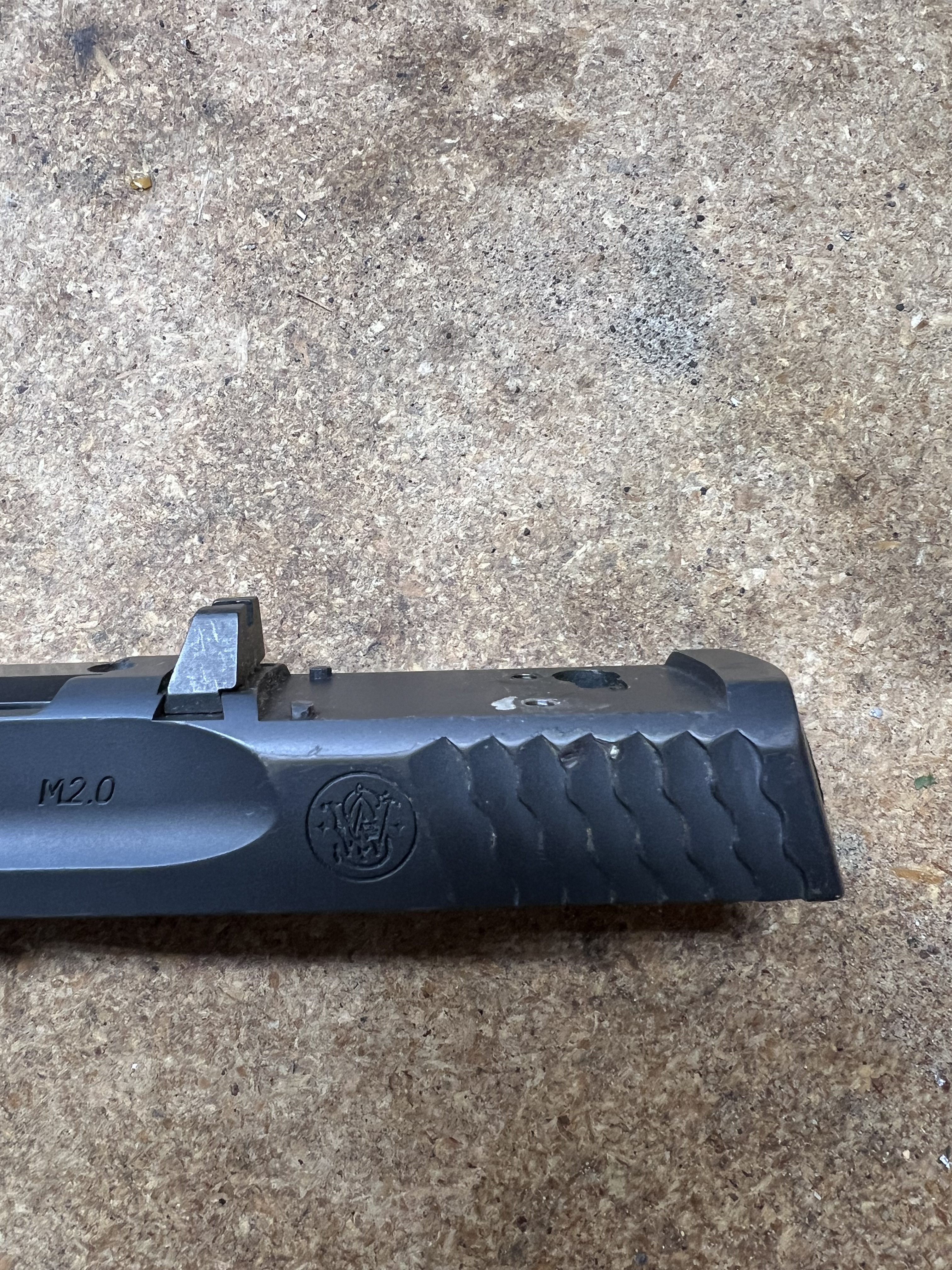

Any one identify this optic cut? Gunbroker auction seller only states M&P 2.0 MOS but doesn’t fit the M&P CORE plates and I don’t have any Glock MOS plates to verify.

I ordered one off Amazon for overnight delivery to try, its the CORE footprint. If it doesn’t work, freeeee return.
I’m not sure its a MOS or CORE style plate system. Almost looks direct cut, maybe Deltapoint? I need to find someone with a Deltapoint I can try. I’d rather use the 508T I have here, not have to buy another optic lol

Also, ordered 2 different “optics” plates off Amazon from CHP. One for the M&P Core series and one for Glock MOS. Neither fits so back to Amazon they go which leads me to believe this is the Leupold Deltapoint footprint as my 508T and RMR both do not fit.
I’m almost wondering if buying $6 expendable calipers and poking around is really the ‘right’ answer, just spending that much time on this feels silly.

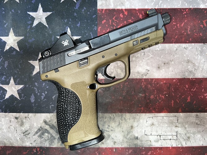

FYI, figured out the answer to my original post. Who ever did the cut originally cut the back of it like a fucktard with a curve. Filed the curve flush. The optic cut is the Doctor/Noblex footprint. Got a vortex venom on it. I do believe this pistol is gonna get sold to fund some other stuff.
