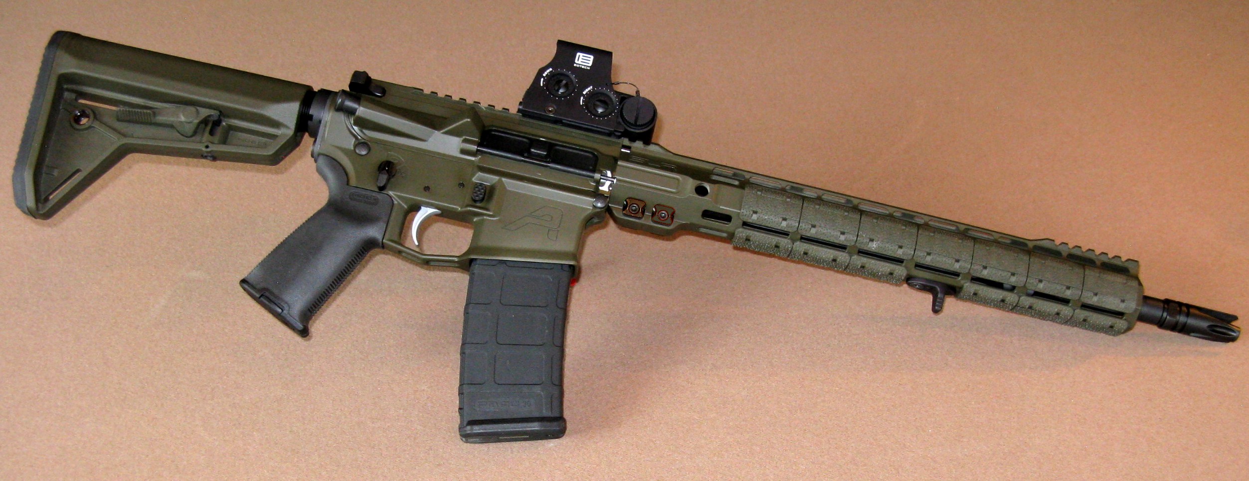

I got the upper, lower and hand guard back from Cerakote today, so I spent the evening putting things together. The gas tube was backordered or it would be 100% finished. I’m still trying to choose an optic, it will likely end up with an Eotech XPS2-0GRN and a set of folding BUS. The Cerakote color is Magpul OD Green

I like it.
I do too.
Very good looking build.
I built an FDE cerakoted Aero receiver set w/ an Aero Atlas R-one rail and have plans to do the ODG color scheme on my Aero M5 receiver set. This picture makes me want to hurry up and get parts to start the build
Updated with a pic of the completed build
Makes me want to have mine done
Thats a great looking setup
You did a great job! I don’t even want to shoot this gun, just keep it up for ornamentation. It’s beautiful.
Are you completely satisfied with Palehorse Zero?
Thinking of sending them some items
Very nice look
Wolf whistle time
They were easy to deal with and actually turned the job around faster than expected. I would use them again.
My fave dot. Looks great.
