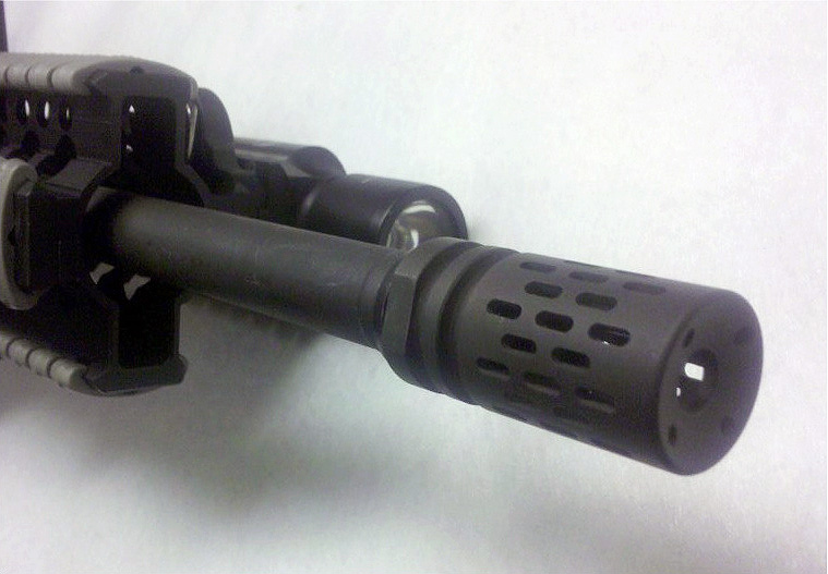

Here is mine on my 10.5" SBR

That’s just a cool photo. Great shot!
