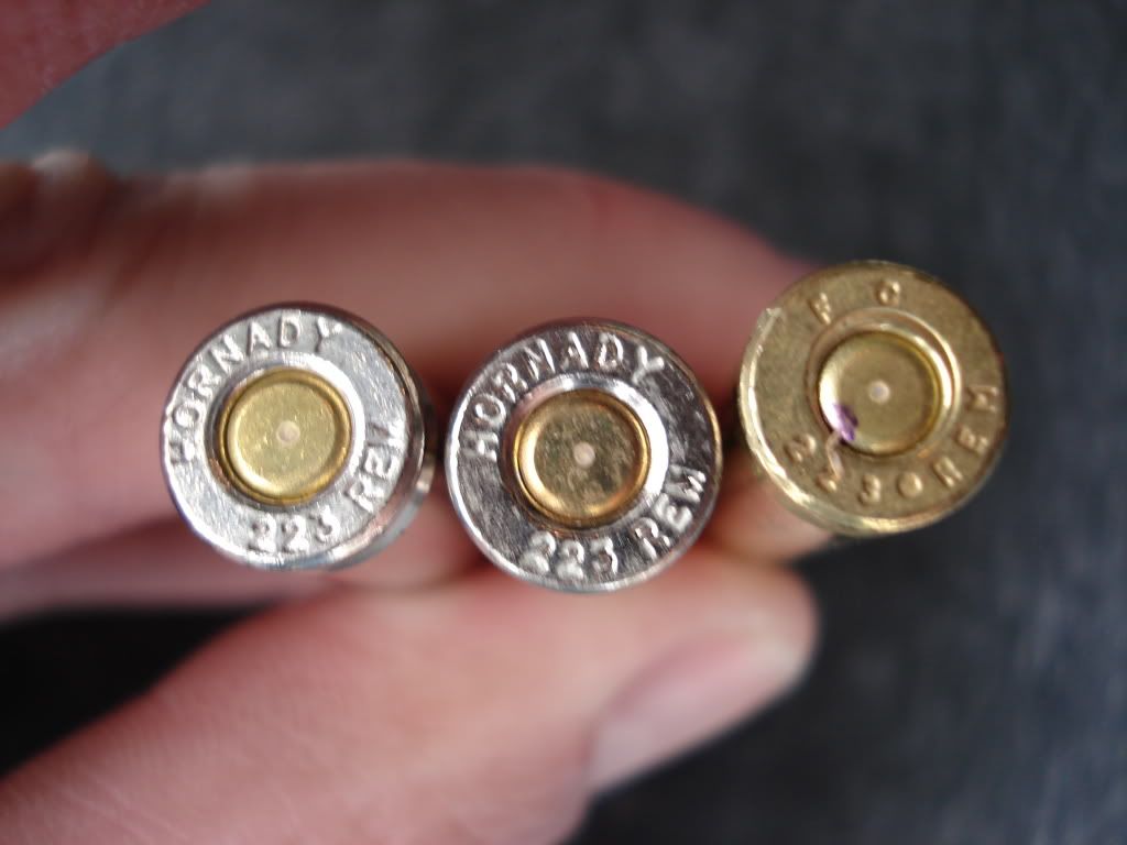

Ok sorry for taking so long to post. I just got back from the range. I haven’t had time to clean my rifle yet either so please overlook the mess.
Before
After
Before
After
Feed Ramps
Might be my eye balls,but am I seeing rifling/leade marks on the ogive of the bullets in picture #2?
I don’t see anything to be concerned about.
Layman’s terms? Im not familiar with that.
nothing to be concerned about.
The feeding cycle of an AR is not exactly gentle. It’s not uncommon in a lot of ARs to see that the rounds get scratched and scuffed up when they are forced out of the magazine, up the feed ramps, and into the chamber. The dimples in the primer are also normal, as the AR uses a free-float firing pin which smacks against the primer when you chamber a round.
