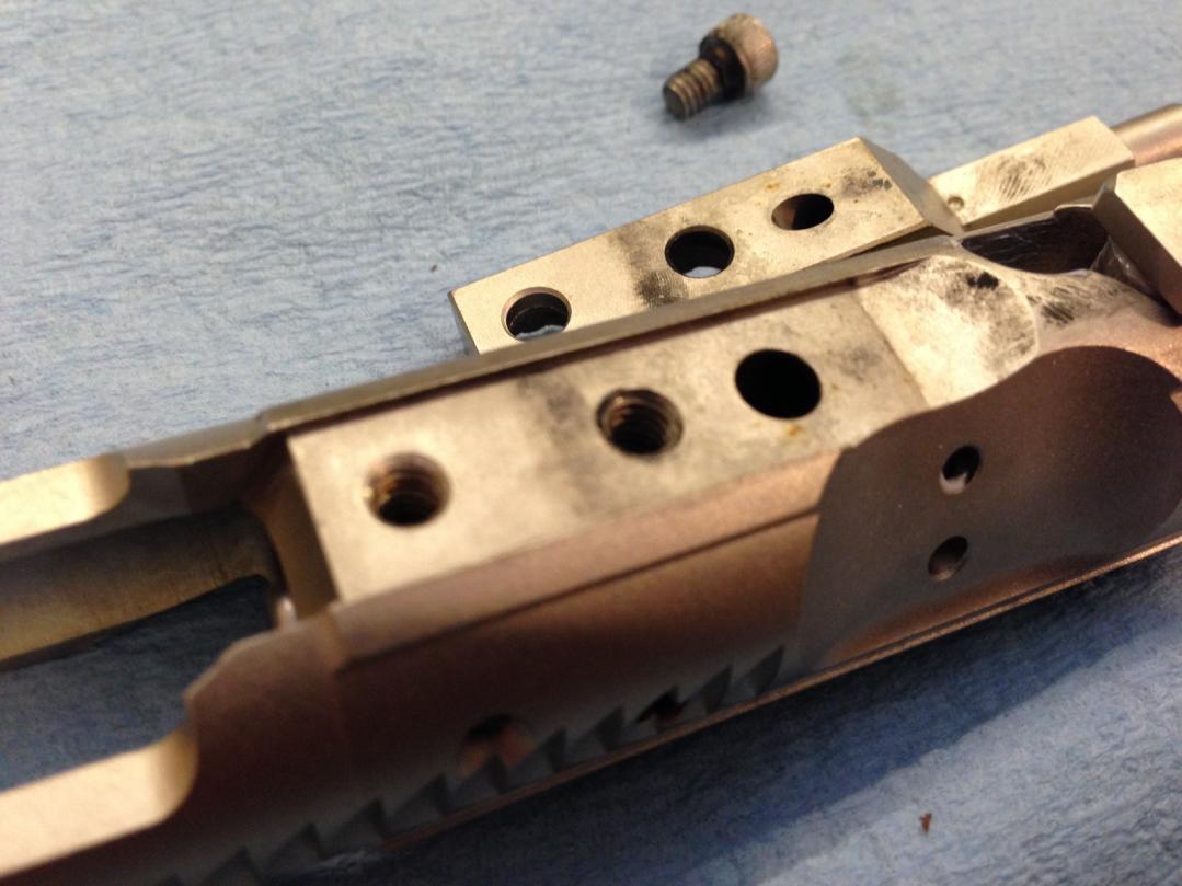

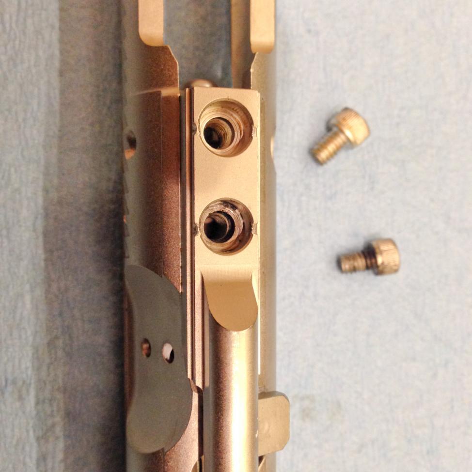

So, I took it apart, intending to clean the mating surfaces, stone them flat if needed, and put it back together with fresh non-plated screws. The front screw was a bit loose, the rear screw seemed to be tight. They were both easy to remove despite the staking. Either the staking was not robust enough, or, the NiB plating made it easier to remove them.

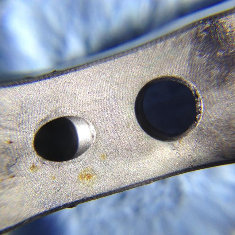

You can see in the photos that the leak was forward, and did not migrate by the tighter rear screw.

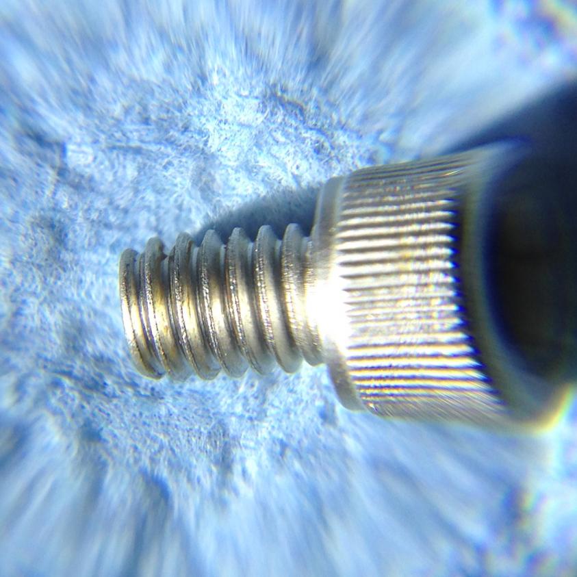

On closer inspection with a 10X loupe, the surface of the key shows light CNC machining marks, and the granular aspect of the NiB plating. You can also see that the screw was NiB plated along with everything else.
It seems to me that the slick nature of NiB plating would make it less likely for the screws to remain in place after torquing, requiring fail-proof staking and/or thread-lock. It also seems to me that NiB plated threads, both on the screws and in the carrier, might not be the best idea.

Bad staking job, bad QC, and why NIB? who’s BCG?
Yep, yep, and good question. This one will get replaced with a non-plated BCG. I don’t want to out the manufacturer until I see how they respond to the QC issues. All American made though!
Any thoughts on how NiB plated screws might underperform?
My only concern would be the key screws being brittle from the coating, if not properly done.
I’ve heard of that. I was concerned that the screw might have cracked. I think the NiB plating is not much different than greasing the threads. It is likely that it changes the torque values and may lead to over-stretching.
This happens more often than not with NiB. Most of the time it’s due to crappy stakings. Yours are not staked nearly good enough.
