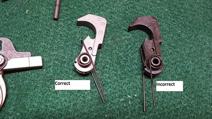

Probably, but double check to make sure the hammer spring is installed right side up before you go back.
So, looking into an assembled lower, the spring legs should be coming from under the hammer pin, and resting atop the trigger pin.
