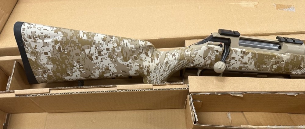

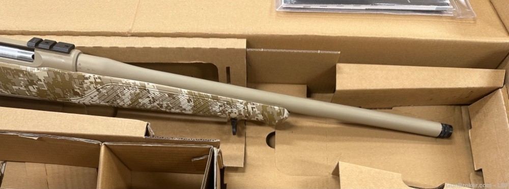

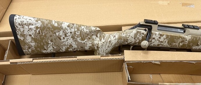

I just bought a slightly used 6.5CM. It’s a JP Sauer Model 100 Atacama with a heavy .750" (19mm) 20" (510mm) factory spun barrel.
