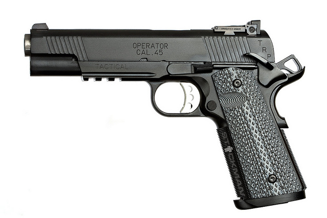

I just picked up a Springfield TRP Operator and am putting together my list for the SACS but I’m torn on a couple things. You guys mind lending your opinion please? This is my second 1911 but first time making bigger changes.
Definitely doing:
10-8 Rear sight
VZ Operator II grips
S&A Arched mainspring magwell
Flush cut and crown barrel
Nub/FBI style slide stop
Standard carry bevel
Checker underneath trigger guard
Torn on:
Matte barrel finish: I’m blacking out all visible parts (trigger, etc) except the barrel and think a nice matte would look good. Hard chrome?
Convert from bull barrel to bushing: Mainly so I can use it in IDPA. If I did the conversion could I swap back and forth when wanted? Before someone says “Just call SACS and ask them” I would except I’ve been kicking this around in my head for several days and went to call them today but missed them by 8 minutes. Plus you guys are pretty knowledgeable.

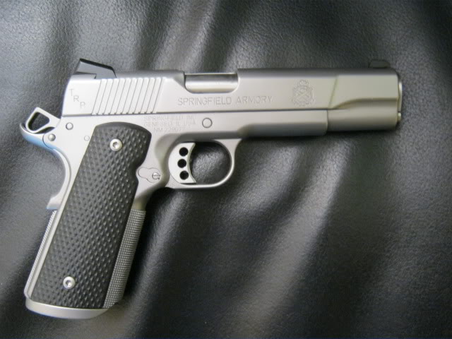

Carry cuts: I’m not big on FCS and I really like the look of carry cuts on the standard TRP but with the rail I’m concerned it won`t look right and be esthetically pleasing. Pictures below for reference. Thoughts?

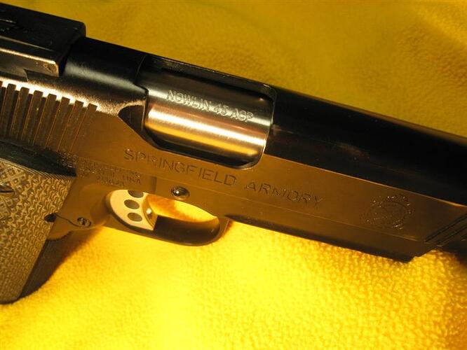

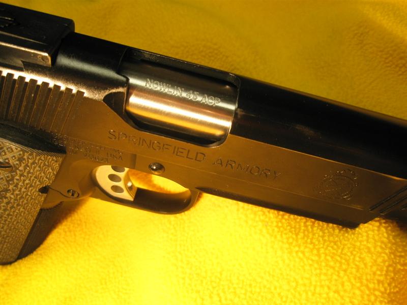

Any finish you apply to your barrel will wear at the chamber in short order if you intend to shoot the gun a bit. I’ve tried about every finish there is on guns/barrels over the years. Any of the phenolic resin finishes (Armory Kote®, Black T®, Armor Tuff®, etc) will show substantial wear on the barrel in fairly short order. Here is what Black T® looks like after about 10,000 rounds on my hard use Pro.
I’ve had a couple barrels hard chromed back in the day. In my experience, hard chromed barrels don’t develop the heavy wear marks as quickly as bead blasted stainless/carbon, blued/blackened or “painted” barrels. In my opinion, there is really no reason to hard chrome a barrel unless you plan to really run the hell out of your gun or are going to be exposing it to salt water or something like that. You might consider just having the outside of the chamber bead blasted (like on the Kart match barrels) and leave it at that.

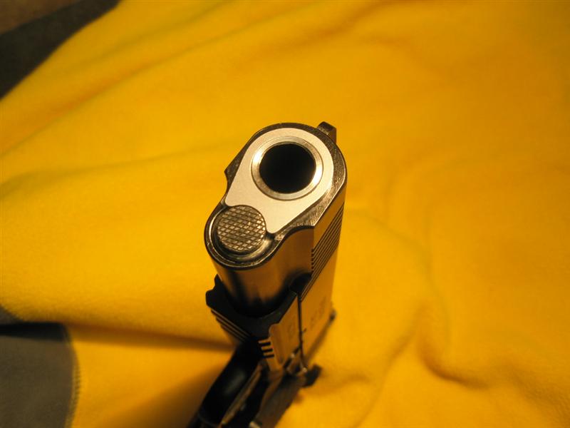

As far as putting a standard barrel/bushing in the gun- that’s what I did to my TRP Operator pictured below.
The TRP Operator’s bull barrel adds some weight to the muzzle which is nice in a hard use gun, but I’ve always been partial to hand fitted, bushing/barrel systems. The Custom shop can definitely put a barrel/bushing in your gun and generally, you could drop the factory bull barrel back in. I should add that a hand fit barrel, bushing, slide stop, frame and slide are fit to each other in a few different places and you may alter some of the key wear points if you toss that factory bull barrel barrel back in the gun for a few thousand rounds. I’ve never really seen a guy interchange barrels on a 1911- but that’s just me. If I had the Custom Shop hand fit me a match barrel/bushing, I’d leave it in the gun.
I would suggest you think twice about having the front cocking serrations removed. If you look at where the front cocking serration cuts begin on the TRP Operator, the front cocking serrations start farther back than the end of the frame’s dust cover. In my opinion, you won’t get a very good looking Hi Power cut look when the Hi Power cut doesn’t match up with the end of the frame’s dust cover. The slick front TRP you pictured has a very well done Hi Power cut as the cut ends right at the dust cover.

Just found this and the carry cuts don’t look too bad behind the dust cover. Has me thinking…

That Rogers gun is beautiful! The only thing that occurs to me is that the dust cover on your TRP is a bit thicker (to make the picatinny interface) than one that is slick- I’m sure Dave Williams will know if the cut in the slide will make the slide thinner than the frame’s dust cover where they would overlap. The Custom Shop will know if it will look “right”.
Be sure to post a picture when you get your gun back!
Oh yes, pics shall be had!
I’ve re-re-decided on the carry cuts. After looking over that Rogers gun I got to looking at mine and think it could look pretty good. The end of the dust cover slants at the same angle as the FCS, and the carry cuts would, so even though the cuts would be behind the end of the cover I think the angles just might pull it off.

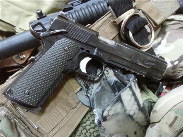

Now my big debate is on the color scheme and I need to decide by Monday when I ship it out. I’m seriously considering ripping off the colors on that Rogers. In fierce competition with that is going all black, like the pistol below.
Posting again for side-by-side comparison:
I’m digging this one more. Black on black is a little plain, IMHO.
The girlfriend voted for that one as well. Nearly every gun and knife I have is black on black so I really should change it up. I’m leaning towards this on the TRP then once I get a DW Valor I’ll black it out.
