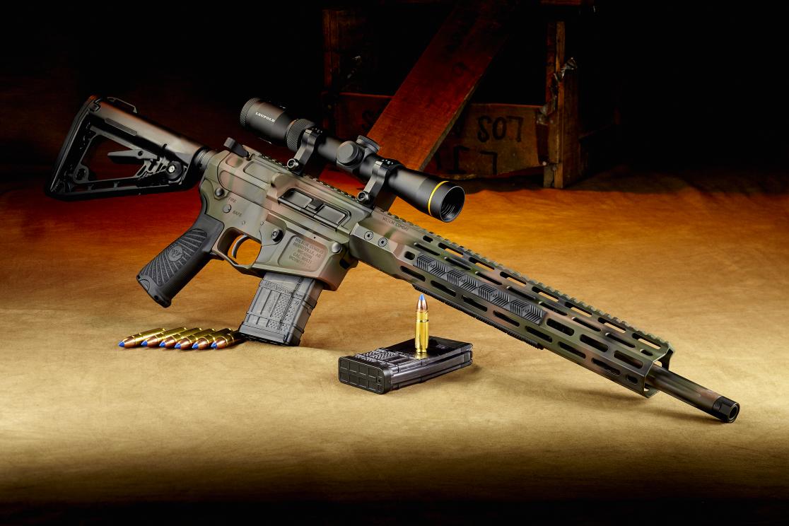

New-The Wilson Combat .458 HAM'R-3000 Foot Pounds of Energy from your AR!
Wilson Combat is proud to introduce the .458 HAM’R.
The HAM’R is designed from concept to completion to be the hardest hitting, most powerful (practical size) AR platform carbine ever produced, exceeding the ballistics of the .450 Bushmaster, .458 SOCOM, and .500 Beowulf. By using an AR10 size bolt and barrel extension, this new cartridge is capable of handling maximum pressures of 46,000 PSI while enabling it to exceed 3,000-foot pounds of energy from a short 18” barrel.
The .458 HAM’R is more than capable of cleanly killing any animal in North America, stopping a vehicle or blasting through a brick wall. Using purpose designed “hybrid” length receivers, BCGs that are ¾” shorter than a standard AR10 and feeding from an AR15 magazine, Bill Wilson and the Wilson Combat engineering team have produced the ultimate heavy hitting semi-auto carbine.

There’s been a lot of discussion about a hybrid sized base for cartridges that would benefit from a bigger cartridges than the AR15 base allows but smaller than the AR10 base. I’d be interested in seeing how far this concept goes.
I’d like to see the documentation regarding the ballistics. Would that $3K rifle kill game any deader than a $1K Beowulf, Bushmaster or SOCOM upper would?
“Using purpose designed “hybrid” length receivers, BCGs that are ¾” shorter than a standard AR10 and feeding from an AR15 magazine”
IMO if they wanted mass acceptance they needed to design an upper that will fit on a standard AR15 lower.
I don’t think their market is mass acceptance. The Glock and 10/22 crowd doesn’t really spend much time with $3000-$4000 guns, but sometimes their ideas make it out into the market. I can’t afford most of what they sell, but I do use their 38 Super mags and have minor upgraded done to projects.
Does Wilson do anything with the goal of “mass acceptance”? Most people who don’t know any better will opt for sub 1k 1911s over a Wilson right? Greater acceptance if the upper fit a standard AR lower sure, but I doubt their market for such a thing is anything past a niche buyer.
One of the commendable things about Wilson in my view is, they don’t do mass acceptance, they do Wilson. Everyone said they’d get better mass acceptance not using proprietary mags in their SpecOp 9, yet waiting lists stretched into years I recall. I believe the new edc-x9 is no different, and they can’t keep those in stock either.
