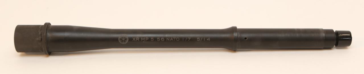

New barrels and uppers are here.
16" 1/8 LW Melonite midlength barrels.
11.5" 1/7 chrome-lined barrels (stripped and FSB) and Melonite barrels.

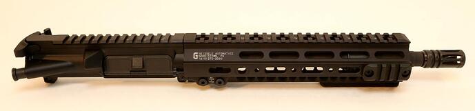

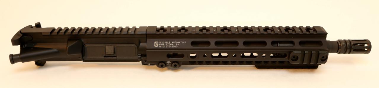

11.5" Geissele MK3 Upper Receiver Group with choice of barrel (chrome-lined or Melonite).

I could use another lite weight. The website says it has a .750 gas journal. The pic looks like a .625, is the website correct? I’m talking about the 16" melonited pencil to be clear.
Edit: Disregard the website is wrong. Also says it is chrome lined.
Thx for the heads up. Will order one.
The web guy wasn’t paying attention and we are getting with him in the AM to make the corrections. They are correct .625 with Melonite.
Is the weight posted on the site correct? 29oz sounds heavy for a .625 pencil. GH
Corrected specs are online for the 16" LW:
11595E CMV 4150 Steel
M4 Barrel Extension
5.56mm NATO Chamber
1/8 Twist Rate
.625 Gas Block
Light Weight Contour
Melonite Finish
Standard 1/2X28 Muzzle Threading
Mid-Length Gas System
X-Rayed and MP Inspected
Barrel Weight - 1 lb. 6 oz.
This barrel might be lighter than BCM’s 16" ELW (1 lb, 6.74 oz) and closer to the fluted ELW (1 lb, 6.21 oz). BCM’s 16" Standard LW Middy is about 1 lb, 8 oz.
I think this is the best value in quality 16" barrels today. For example, the BCM ELW is almost $50 more and isn’t melonited (but has a theoretically superior profile). The ARP 16" LW is $20 more and weighs 3 oz more, though it has a Wylde chamber. I tried a Brownells 16" LW melonited barrel but the gas port was so huge, I returned it.
