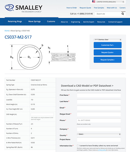

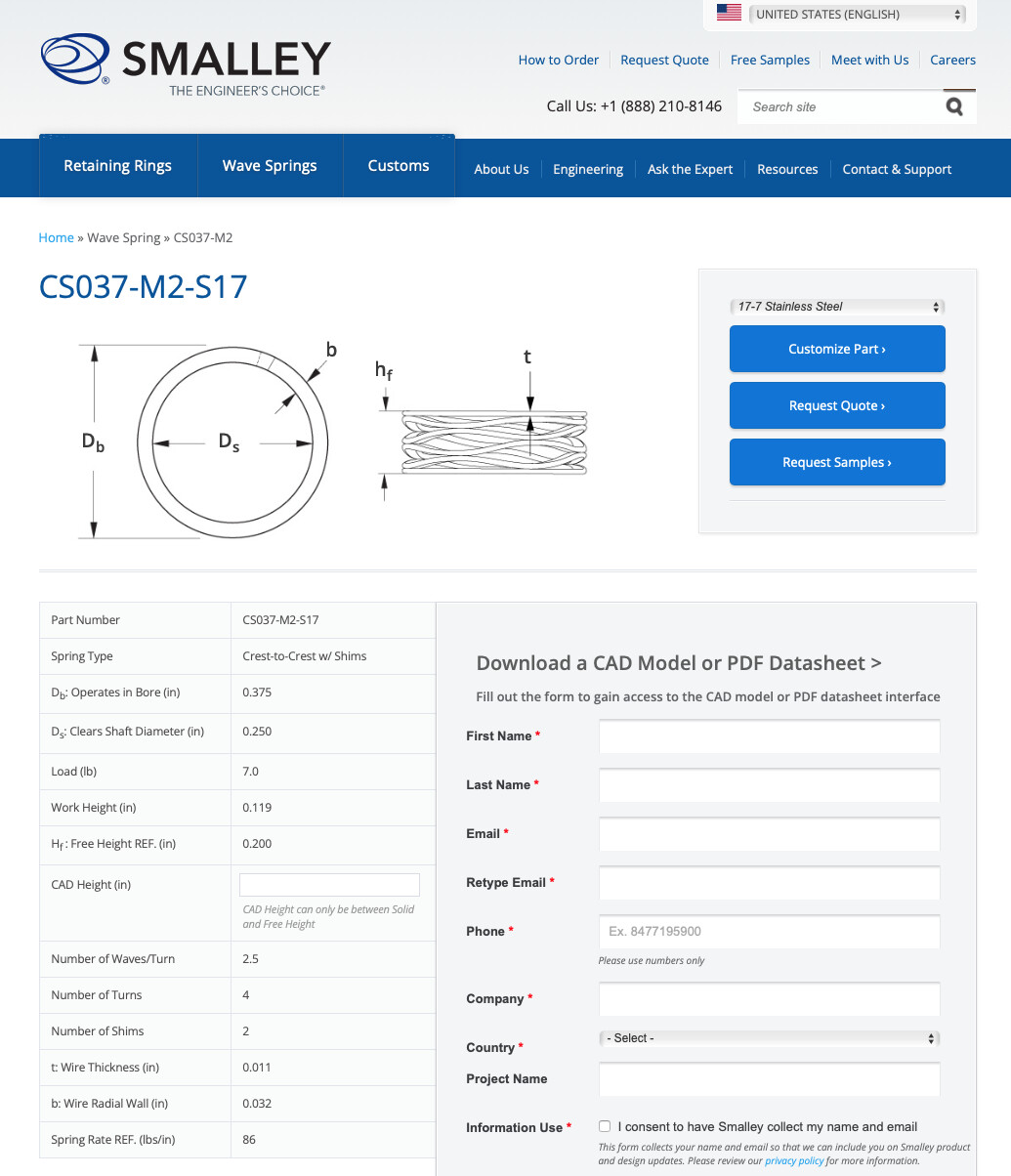

While searching for the apparent part number, “CS037-M2-S17”, I ended up at a spring manufacturer’s website. Anyway, just thought I’d throw it out there.
Did you order from them? Looks like a mass mfg type site. Ie they build one for you then you buy 10,000
