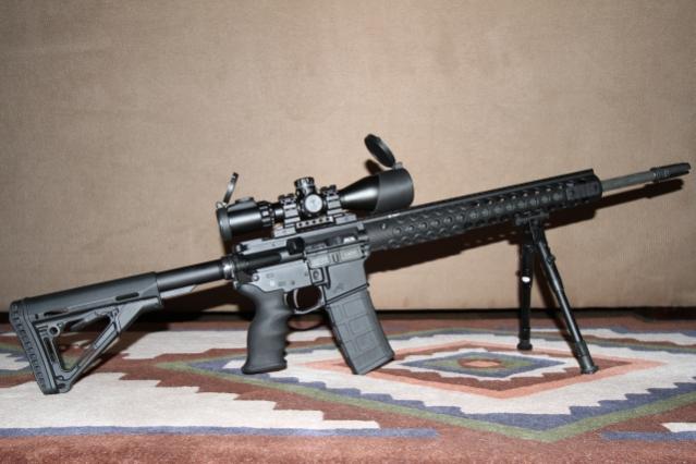

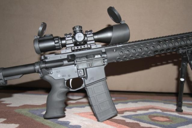

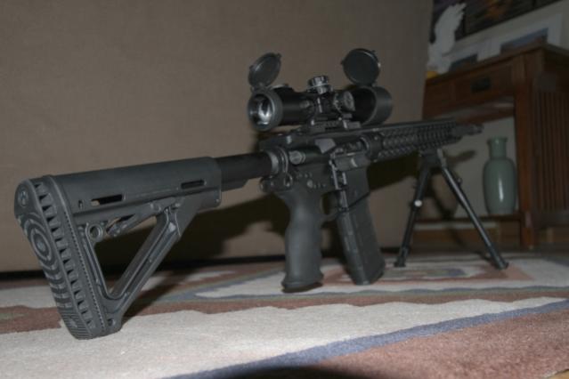

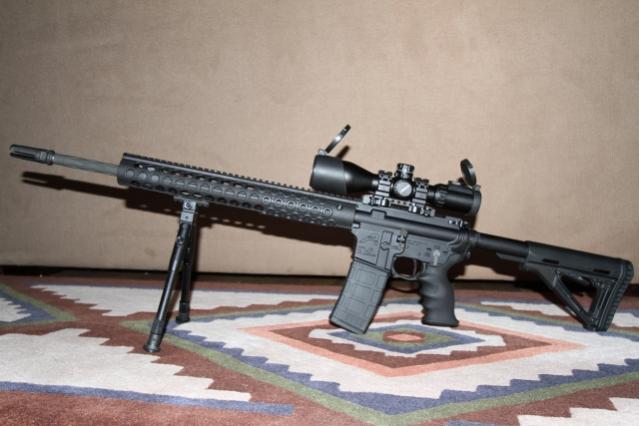

Thought I’d share the pictures of my latest project. First off, here’s the parts list:
So, here’s the parts list for the lower receiver:
Aero Precision Forged Mil-Spec Lower Receiver $88
Mil-spec Carbine Length Buffer Tube Kit $34
Magpul CTR stock $76
Enhanced 7/8 rubber buttpad $17
Ergo Pistol Grip $17
Lower Receiver Kit $23
Timney 4 lb trigger $209
JP Enterprises Captured Spring Buffer $135
The upper receiver parts list:
Aero Precision Forged Mil-Spec Upper Receiver $90
Molon Labe Engraved Dust Cover $15
Forward Assist Kit $18.50
BCM M16 Bolt Carrier Group $189
BCM Gunfighter Mod 4 Medium Charging Handle $45
Tactical Intent Barrel Nut $15
Troy Low Profile Gas Block $32
Yankee Hill Machine 20 Inch Barrel, Threaded, Fluted, $200
Rifle Length Gas Tube $13.50
Ejection Port Dust Cover Parts $3.43
Troy Alpha 15" Free Float Handguard $180
Troy Squid Grip Pack $24
Sure Fire SOCOM Flash Hider $128
One editorial comment: The scope is a temp while I save my pennies for the Leupold VXR 4-12x50mm I really want.
Pictures:
Aero Precision AR Build IMG_3047 640x480.jpgAero Precision AR Build IMG_3048 640x480.jpgAero Precision AR Build IMG_3049 640x480.jpgAero Precision AR IMG_3046 640x480.jpg
