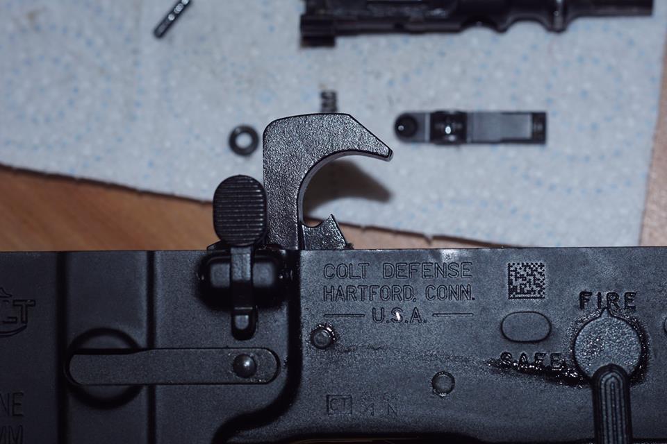

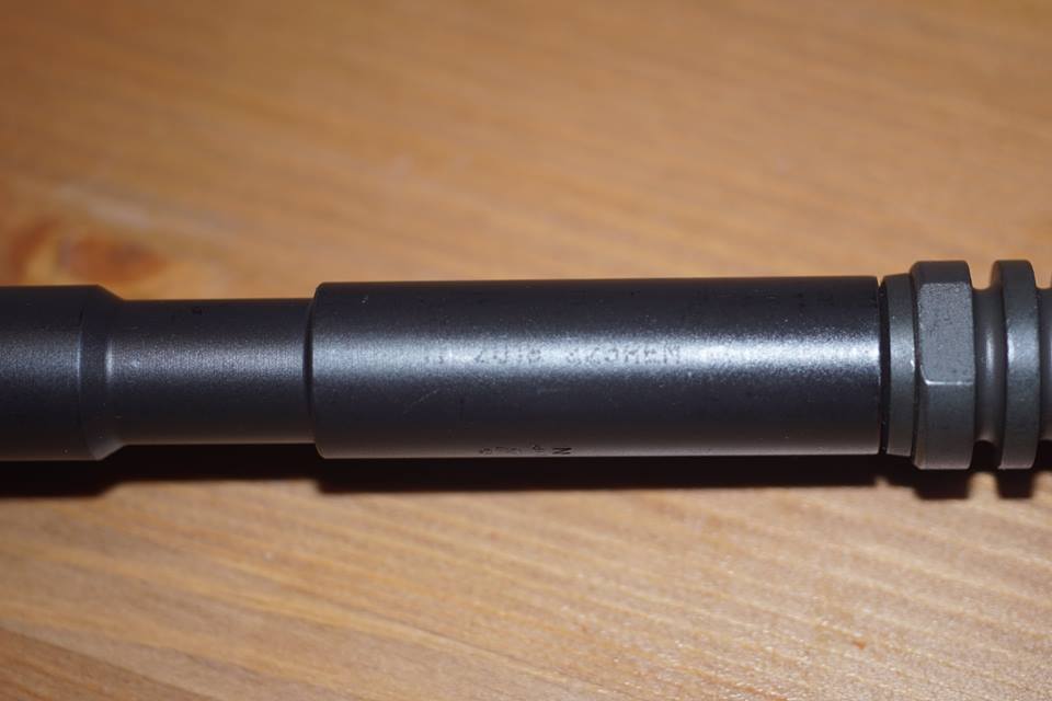

Customer brought in a “Colt Defense” M4 Carbine bought earlier this year in another gunshop. The carbine come from Italy (IT 2018 laser-marked on the barrel, Italian proof house stamps on upper, bolt carrier & barrel).

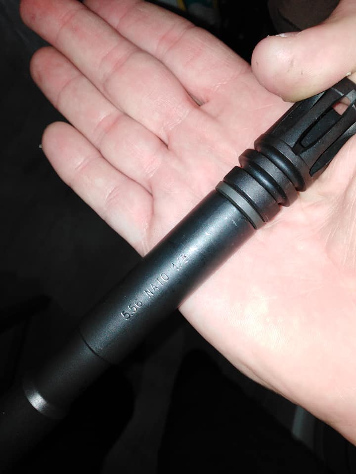

But I think that the only part made by Colt on this “Colt” is the lower receiver itself…The barrel is marked “5.56 NATO 1/8”

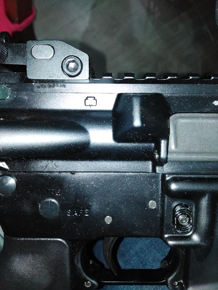

The only thing i can tell is that it has a mueller industries upper

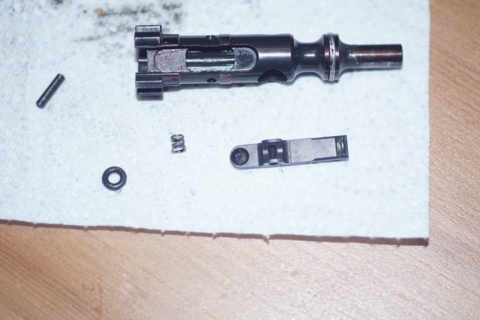

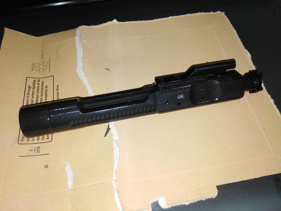

aftermarket BCG - definitely not mil-spec
unmarked upper - not a Colt for sure
Does not appear to be a Colt based on the pcis.
Yes, it’s what I told myself: neither the upper, the BCG or the barrel are Colt. The bolt is unmarked.
Looks like an Italian distributor is importing Colt Defence firearms and rebuilding them with their own-sourced upper assembly. The charging handle is very, very soft. The barrel extension is parkerized.

With a unchromed 1:8" barrel 14.5" barrel ?

Definitely not a Colt bcg, fire control group, or barrel. Looks like Chinese junk.

Mueller Upper:Probably finished by Aero for PSA

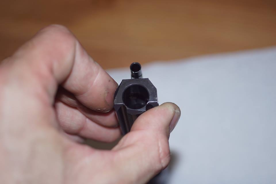

BXG… if you look at the stake job on the Key, you can at least gauge the quality…
