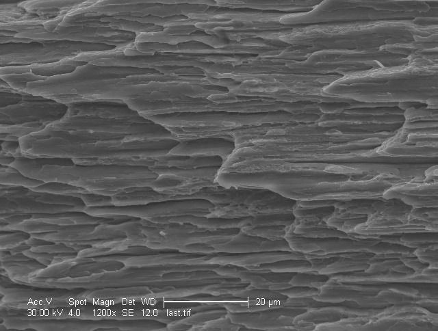

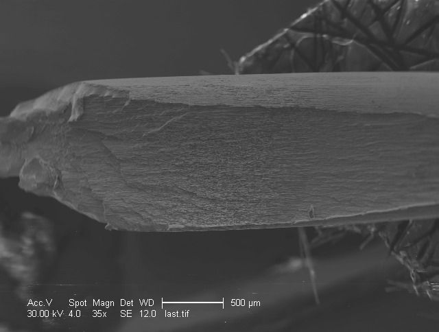

In order to achieve the best results, my friend and I agreed that we should scan both the inside and outside of the springs. This would ideally tell us if there is a coating on the springs (like molybdenum) or not. I pulled a Glock and Wolff spring from my collection, cut them in half, and sent them down to Drexel University in Philadelphia – where we both went to school.
Upon receipt, my friend treated and cleaned each spring so no outside materials like gun oil would corrupt the data. Each spring was then subjected to testing on both the cut portion of the spring (cross section) and the external portion of the spring (surface).
For the Glock spring, the results show that it is high in chromium and iron – i.e., stainless steel. In particular, the testing shows that the Glock springs are either 301 or 316 stainless steel, though probably 301 since it is widely used as a spring steel. This is slight conjecture, though, as neither of us possess an exhaustive knowledge of stainless steels.
For the Wolff spring, the results show that it is…iron, and really nothing else. This isn’t a huge surprise, as light elements like carbon don’t show up well in SEM tests, but considering this is a steel spring, we know the carbon is there and just doesn’t show up in the test (same goes for the Glock spring). Therefore, the Wolff spring is some type of carbon steel, though we can’t scientifically say which type with any certainty.
There are also a few other elements in there, mostly of note being silicon. Both springs, he guesses, were coated in some sort of silicone-rubberish coating, and the Wolff spring also shows some zinc, meaning it may be galvanized in some way.
Either way, the take away here isn’t the coatings or other elements. The take away is that Glock magazine springs are stainless steel and the Wolff springs are carbon steel. No magic. No Keebler Elves creating mithril in the Appalachian Mountains. No incredible advances in material science. Just stainless and carbon steel.
Hope you all enjoy. :slight_smile:
(NOTE: data labeled IA are related to the Glock springs, and data labeled IB are related to the Wolff springs. Micro images show what was tested – which was a rasterization of the entire image. Macro images included to simply show where the micro images were taken: the center of the picture. PDFs included with approximate element quantities. I did not include some extraneous data, as this is the important stuff.)
