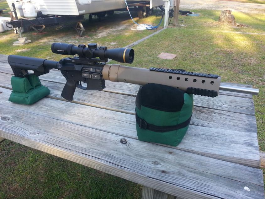

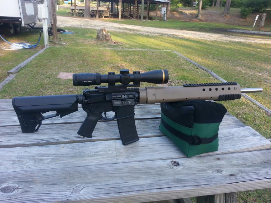

Have it all assembled now! Quite a job for a first timer. Put a Leopold vx-6 2x12 on it for now. I don’t really understand the whole tactical scope thing but I am trying to learn. The scope will go on a rem. 700 that bartlein is rebarreling now. My deer rifle.
Going to the range tomorrow. Have a selection of Ammo to try both .223 and 5.56. Standard 55gr federal 5.56, 62gr lake city 5.56, Black Hills 77gr sierra matchking. Standard 55gr .223, 69gr hornady match, 69 gr Black hills sierra matchking.
My expectations are high. I’ll post pics of the gun and hopefully some good groups tomorrow.

One of the most valuable parts of my recent build experience was really beginning to grasp the genius of Stoner’s design, and how it all goes together. Welcome to the 20" rifle family. That said…
Here is another one
Nice, kind of a DMR build. Let us know how she shoots.
Looks sweet! Congrats.
Nice! Good job.

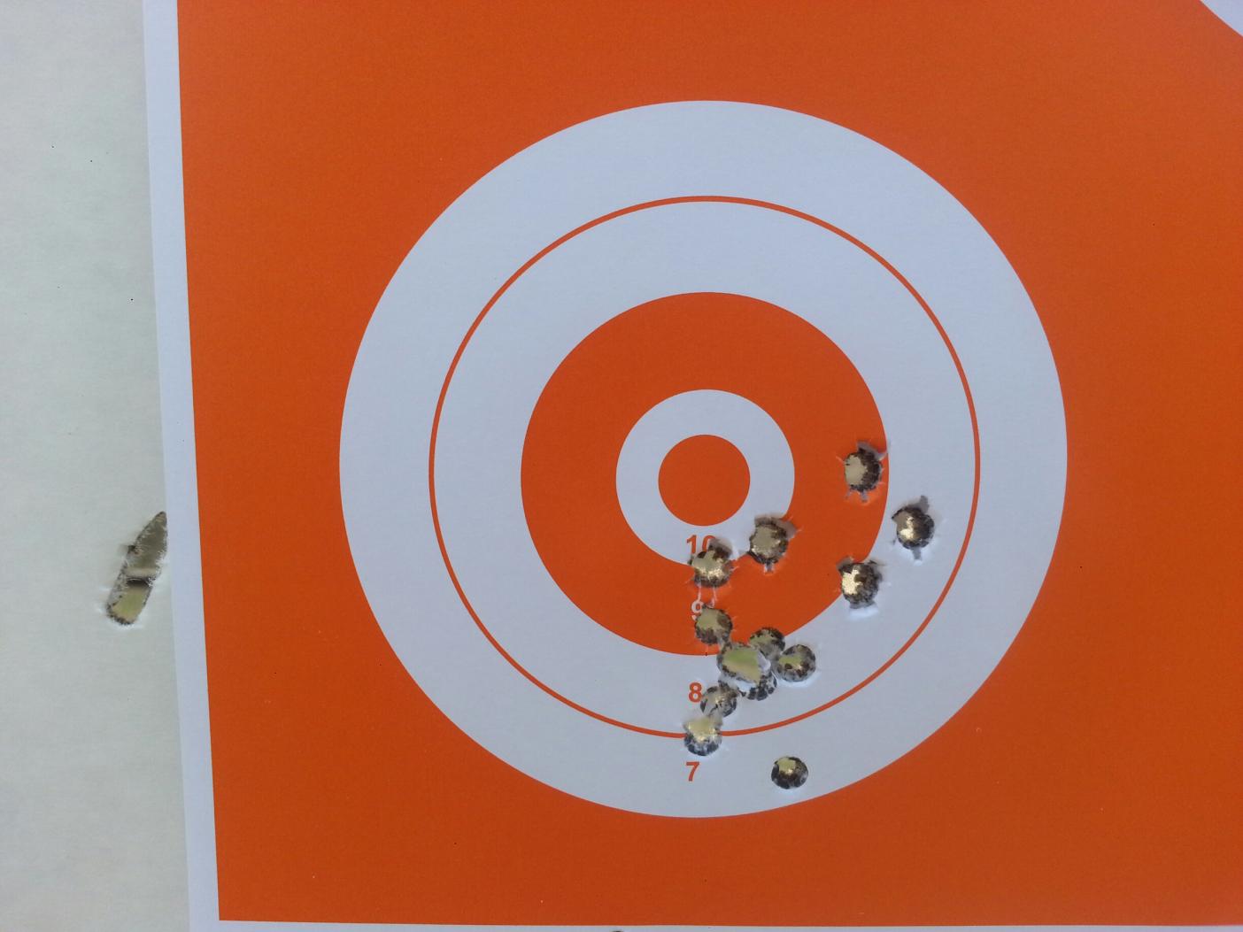

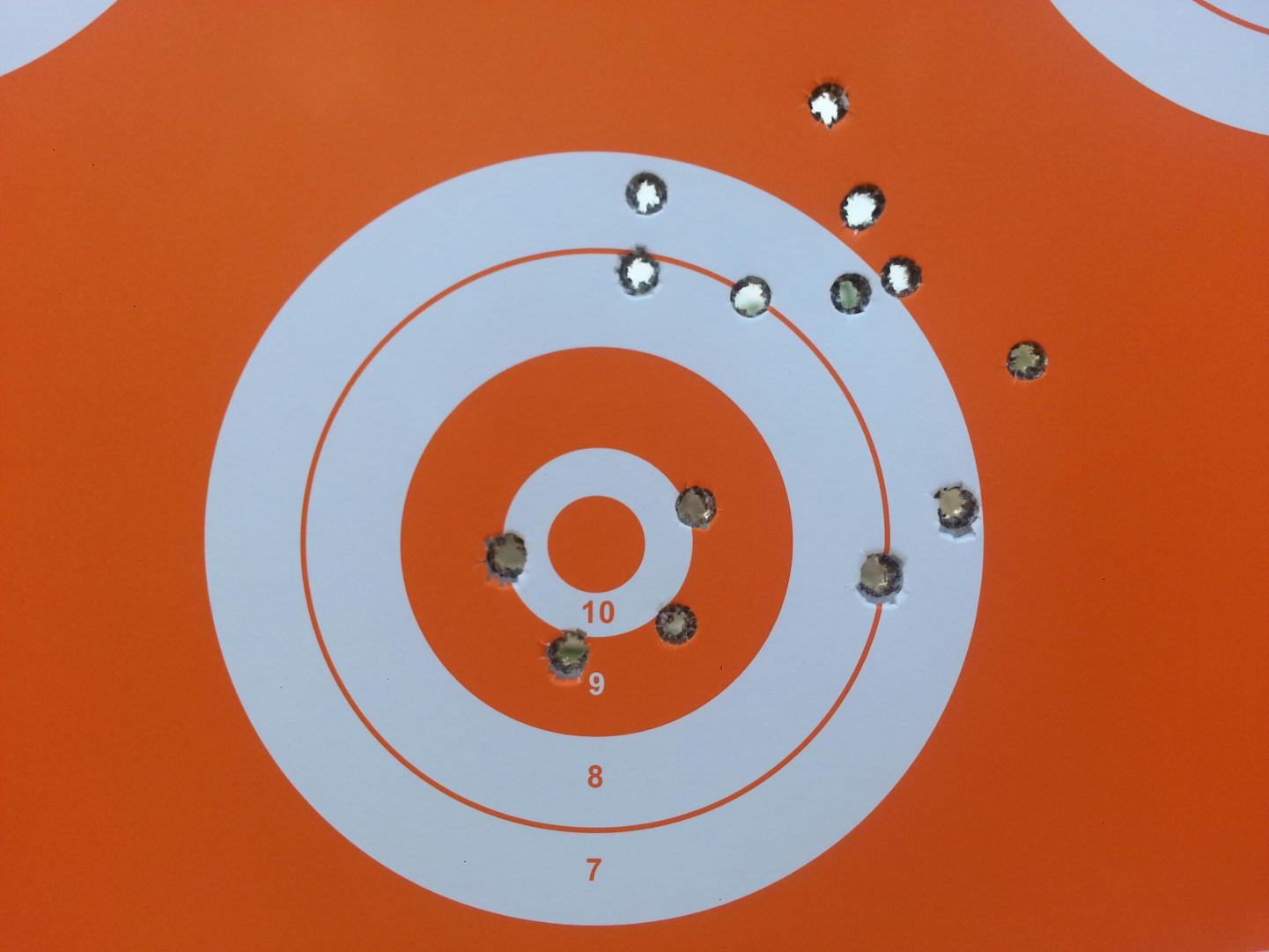

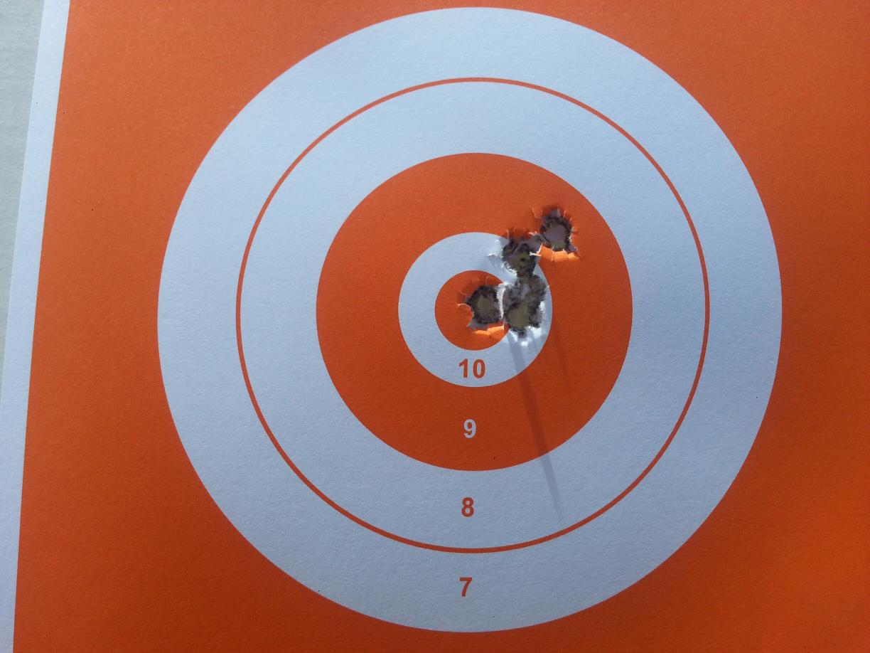

Well more interesting developments at the range today. Pics to follow.
Last night when I was cleaning the gun i decided to remove the scope. When I undid the levers on the larue SPR15 removable mount i noticed that the tension on the levers seemed light. Read the directions and tighten up the levers.
This is my first target today with a cold clean barrel. I am not displeased but I think I can do better
From there things went downhill fast
After 5 five shot groups and the worsening results I checked the mount again. The front lever was tight but the back one had losened again. I took the mount off, reattached it and shot another 5 shot group . You can see it is another tight one burried in the larger group in the second pic.
Could it be the mount? or is it just the barrel going away as the fouling starts? I didn’t clean at all at the range today.
