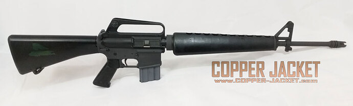

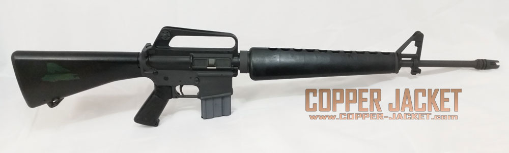

My 604 project, finally!
After 9 months, I finally got my 604 clone together. There’s an easter egg/minor oops of sorts in one of the photos in the link… 3 internets to the first one to figure it out. Aaaaaand… GO!
http://copper-jacket.com/wordpress/2015/03/01/retro-ar-build-colt-604usaf-m16/

I suck at patience, but I love to obsess over details. I’m a little pissed at myself for pussing out on the BCG and going with the later variant to save time and money. I really didn’t think it would bug me this much, (notice the dust cover is tightly closed in every photo. LOL) and I might very well still end up with a slick chrome BCG because… well… just because.
I know what you mean about details. My 602 has a DPMS slickside chrome carrier that I picked up from a guy on ARFCOM a few years back. I recently changed the BCG in my XM607. I had a Colt M16 BCG, but the build really called for a chrome M16 type carrier w/ serrations. I searched high and low for a carrier like that, but was unable to locate one. I ended up buying a WMD NiB-X M16 carrier and putting it in there. Before it came in, I had contacted a resource of mine to see if he has a chrome carrier like what I was looking for. It turns out he did and it will be here next week. So, I can put the chrome carrier in there that should be there and use the WMD BCG in another of my ARs. Trying to be correct can be a pain and costly, but it is worth it in the long run. Trying to find a chrome slickside carrier is going to be a chore. They are hard to find these days. I hope you have good luck and run across one that does not cost you an arm and a leg.
