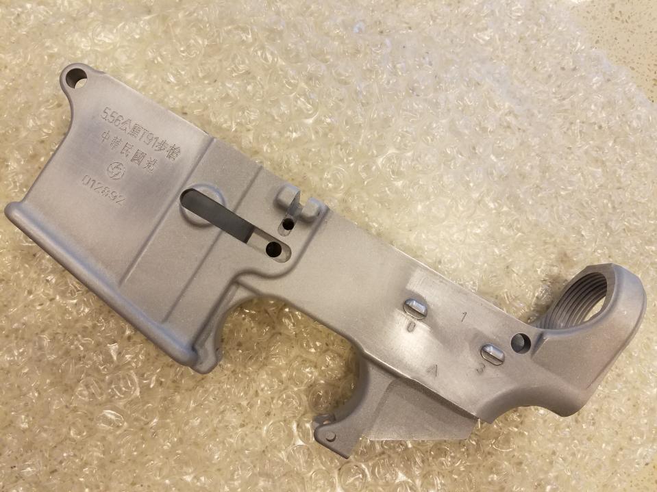

so as the ownership experience is great for a 600.00 complete upper, I was not satisfied with owning a almost like a T91 carbine. I want it to be as closely replicated as possible.
this was the initial set up, build around an 80% receiver I built in 2015.
Later I was given some Taiwan T91 original furnitures.
but is was still not enough, the gas block and the barrel just bugs me to no end…plus not having the proper receiver. so I embark on a venture that required the help from many good friends.
First I had my friend Alex Ko do the art work on the computer, at first we thought just laser engraving the receiver.
I have seen some engraving work on the internet, but all of the work out there were based on a WE airsoft copy and the airsoft riffle made the mistake of using an A2 receiver, making the fonts for the markings way too small and position the marking an inch lower than the real thing. but I guess I am just that anal so those mistakes were unacceptable to me, so I had to embark on the make my own T91 receiver venture, this is where Monty at Centurion Arms came to the rescue, he was able to machine my A2 lower into an A1 configuration and Monty decided that laser engraving was not original enough so he figured out a way to actually have engraving done properly on my 80%. he was able to translate Alex Ko’s work into CAD program and engraved my A1 80% receiver. Once I had the engraving, I took my 80% and got it anodized.
The upper was completely disassembled by gunsmith wizard Dave Lawver, he took apart the upper, cut the barrel to the original length, turn the barrel down to match the original profile and make sure the original gas block will fit and then drill the hole on the original GB to match the port on the barrel(yes, the port on the GB was not drilled) once assembled it started to resemble more like the original T91.
Only one area where is right underneath the charging handle on the lower receiver that is not copied correctly, but I would say the accuracy rate if about a good 97%.
If you want a A1 80% receiver with the proper engraving, you can contact Monty at Centurion Arms to buy his T91 A1 80% receivers.
