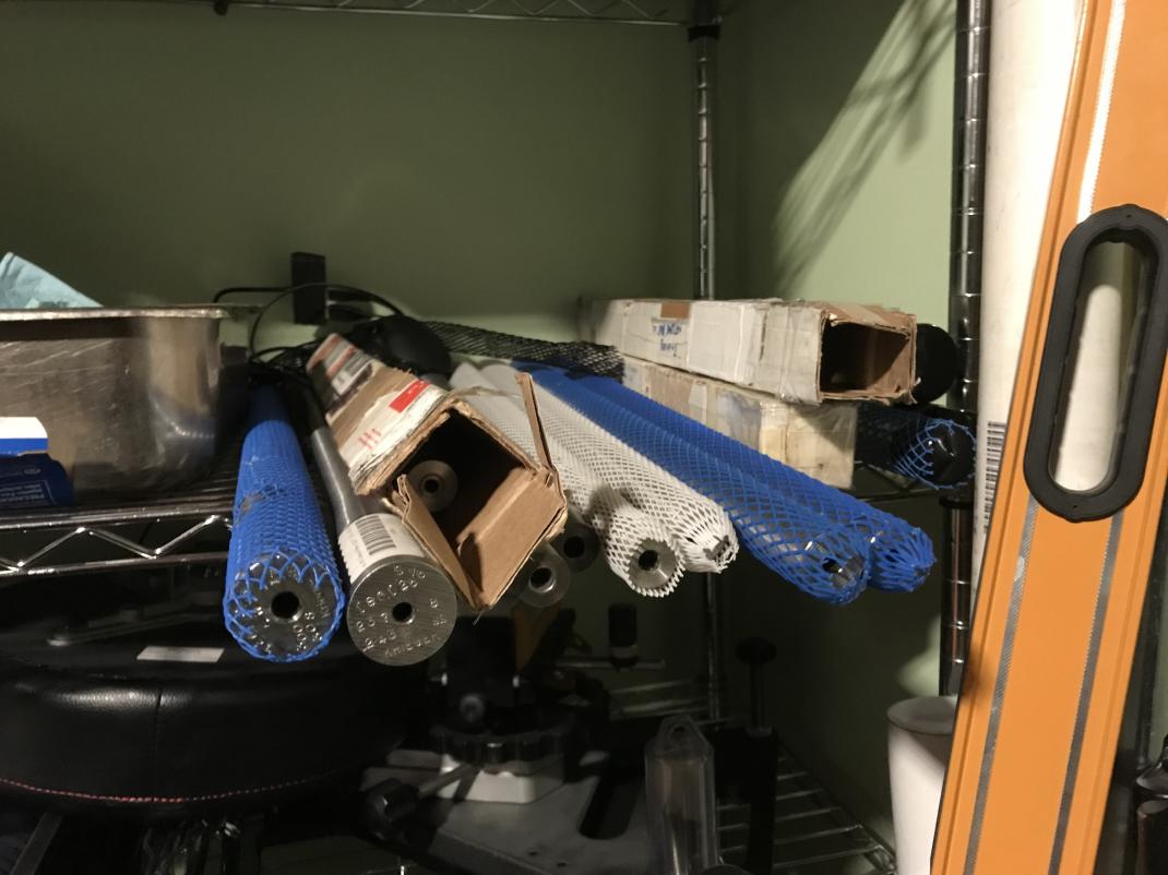

Here is my pile of 13 blanks that I have at home, also have 2 with gunsmith, one of which should be out of the lathe today… I know what I am doing this weekend.
