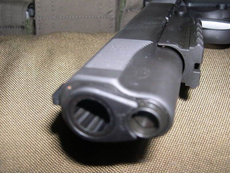

This is after a very hard use summer as I was lucky to be able to shoot often. It was carried in either a HSGI drop leg rig or a 6004. It was drawn 100’s if not low thousands of times.
Additionally, someone who wanted to check it out dropped it on a concrete floor and THEN kicked it across the floor as he bent down to get it.:eek: It was also dropped once at a gravel pit where we shoot. Add that my sweat is stronger than an Alien creature’s blood and it was a rough few months.
Nonetheless, outside of a little zinger on the Heinie rear sight, there is ZERO visible wear. The pistol ate a little less than 12 cases of ammo without a hiccup. The barrel is Melonized inside as well.
I highly recommend it. CCAs site is down right now but the phone number is there. Ask for Tony. Cost last Dec. was $200 with a 4 week wait. I hear the wait has grown considerably but it’s worth it. Just another option for you.
