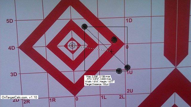

M193 holds 2 MOA or under.
The following group is with Freedom Munitions Remanufactured .223 ammo when I was zeroing. Red dot and the target was getting blown away by the wind, put together a rough group before it blew off.
