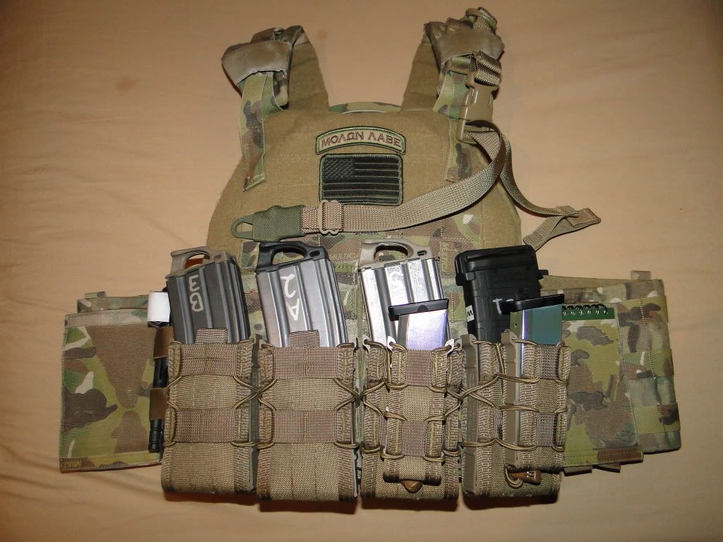

I just recently started using the Emdom URS and it’s pretty damn long. I use it with the PIG so I can use the double d ring or buckle kit to hook it to the ladder system on my shoulder pads. They have a pic on MilitaryMorons showing it attached to the back of a PC so I imagine it’s long enough, the link is on Emdom. I attach it to the far back of my shoulder pad and it’s still adjusted to about half the legnth.
The pic shows it attached using the double d ring and the buckle attachment they provided, I can eliminate that by using the buckle from the PIG…
I was somewhat thrown off by the description at that link: “Sling that runs through both shoulders and attaches to the single release point FSBE2/RLCS vest.”
Is that the one you have? How long are the straps on the back?

One more question, does anyone utilize the “D” rings on the shoulders of a eagle plate carrier to support a carbine? Are these up to the task? The reason why I was asking about a MOLLE attachment is they looked like flimsy plastic.
Blue Force Gear offers the MVS (Modular Vest Strap?) for this very purpose, and I’ve used one successfully on IBAs and plate carriers from Paraclete, Eagle, and BFG.
1" Acetal or Nylon D rings from National Molding or ITW will support your rifle so long as they are not regularly or unreasonably shock loaded. Transitioning to secondary should be fine. But. I see no reason to not route some 4088 over it and anchor it on one of the rear platebag’s rungs.
Just to update this thread, my fears of breaking the D rings on the carrier were unfounded. I used a eagle plate carrier with the sling attached for a fairly intensive 3 day carbine class and they held up fine. For the sling I was using a Emdom URS in the regular length.
