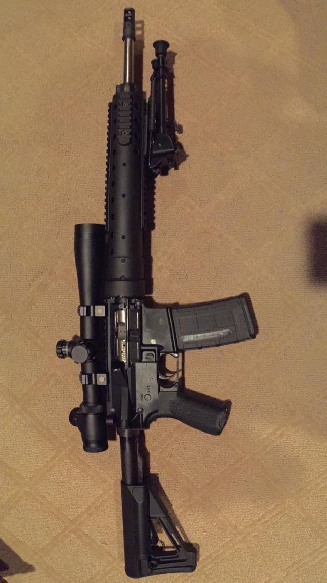

I’m new, my first AR15 build. Here are the specs to my upper
Krieger barrels 18 inch stainless steel 1-7.7 twist .750 diameter with a rifle length gas system
Seekins Billet upper
Spikes tactical full auto NB BCG
Surefire 5.56 muzzle brake
PRI Gen III hand guard
Syrac ordinance .750 adjustable gas block
I’m almost done with the lower but I cant decide on what kind of buffer system to use

Heres a pic with my colt le6920 lower
