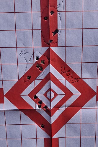

While I agree with you for the most consistency, weighing cases is the last thing I’m ever gonna do, LOL I’m not shooting PRS/Benchrest, etc and I’m fairly content with decent accuracy at minimum involvement. And yes, I am lazy, LOL. Just trying to develop something decent that may hang together well @ 2/3/400yrds, after all it’s only a 5.56 so I’m pushing it to say the least. I know markm and PB push it out to 1K and just have fun with it and I will be doing the same just for shits & giggles. Here is a target/group I shot a week or so ago with my 18-inch Ballistic Advantage bbl and an 8x scope, still gonna tweak the load and maybe swap a primer and see what I get and call it a day.
Velocity is down coming out of an 18-inch bbl but I’ll just deal with it, LOL Thanks everyone for their thoughts and ideas, I plan on getting out Sun/Monday as the weather is getting bearable in my neck of the woods so I will update after I hit the range. The top target is just some generic 55 FMJ bullets over TAC,2nd one is Berger 77 over CCI 400 SRP, and N140 @ 23.5 bottom is the same but a bigger dose of N140, can’t remember now I don’t have the info in front of me. Velocity for the 77s out of the 18-inch bbl was, 2310.5 AVG with the 23.5, ES was 78/SD 27.4. The next 77-grain load was 2454.3AVG with ES of 40.8 & 13.3 SD. Everything was better with a warmer load. I guess I will sort by year and see if that helps & I also have some new Starline 5.56 brass so I will load some of that and see if I get any better results. More info coming! All shots are @ 100yrds from a decent rest.
To me, what you’ve got there is acceptable.
I too have a BA 18", and my 75gr OTM, 55gr SP, and 62gr FMJ & SP loads all show groups just like yours. Same in my other barrels too, BA 16", PSA & DSArms as well.
I’ve taken the 62gr FMJ load to 460 yards, with both BA barrels, with excellent results. 1st round hits on steel 12x20 all day, once I learned the dope.
So to me that looks good. I get just a bit tighter groups w/ same headstamp, and I absolutely know they’d be tighter still if I sorted cases by weight, AND weighed every single charge.
I just have no real need, ot desire, to do the extra work. I’m less concerned about shaving 1 /16" off a perfect group, in perfect conditions, than I am abouy just hitting what I’m aiming at.
The last coyote I smoked didn’t look at his side and say “is that POI perfect?”, he just dashed a few yards and went DRT.
That sounds good to me! Last night, I took the brass that I had prepped and looked @ the headstamp, sorted 10 02-LC and 10 04-LC, and pulled them aside. I had it already for my bolt gun/brass prep so I ran them through my mandrel die. Loaded as usual but put a very light crimp on 5 out of the 10-02 brass with the Bergers. On the 10-04 brass I did the same but loaded 5 Sierra 77TMKs & 5 of the Berger OTMs all loaded to 2.250 OAL, no crimp. Then I pulled some new Starline 5.56 brass from my stash, ran the mandrel through them, and loaded the same (24.8 N140) so I will get an idea if it’s a brass issue. I can’t get to the range till Sunday but plan both Sunday & Monday to finalize everything and go from there. I have a ton of Nosler 77s and some Hornady 75s also but as good as they perform I think the Berger & TMKs are a tic better, I’ll find that out as I go along.
Never tried those, but I’ve shot alot of 75gr Hornady BTHP (basically an OTM), and they perform very well, even out of a cheap-assed BCA barrel.
This experiment you’re performing is excellent, pure reloading experience right there. Eager to see results.
