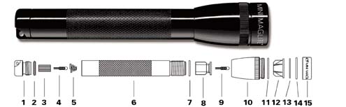

I found this parts diagram online -
#14 is listed as an o-ring
#13 is the lens
#12 is the reflector
#11 is another o-ring
Thanks, Kev.
There is a groove in the back of the collar (in front of where the lens sits), as if an o-ring (#14) would/should fit there, but there wasn’t one there in either of my Mini-Mags.
There IS an o-ring behind the reflector, but it sits behind the threads on the head. It doesn’t cushion the reflector or lens, it seals the face/head together.
zBattery lists an “O-ring for face cap.” It’s 50¢. I bet that this is what I need…
