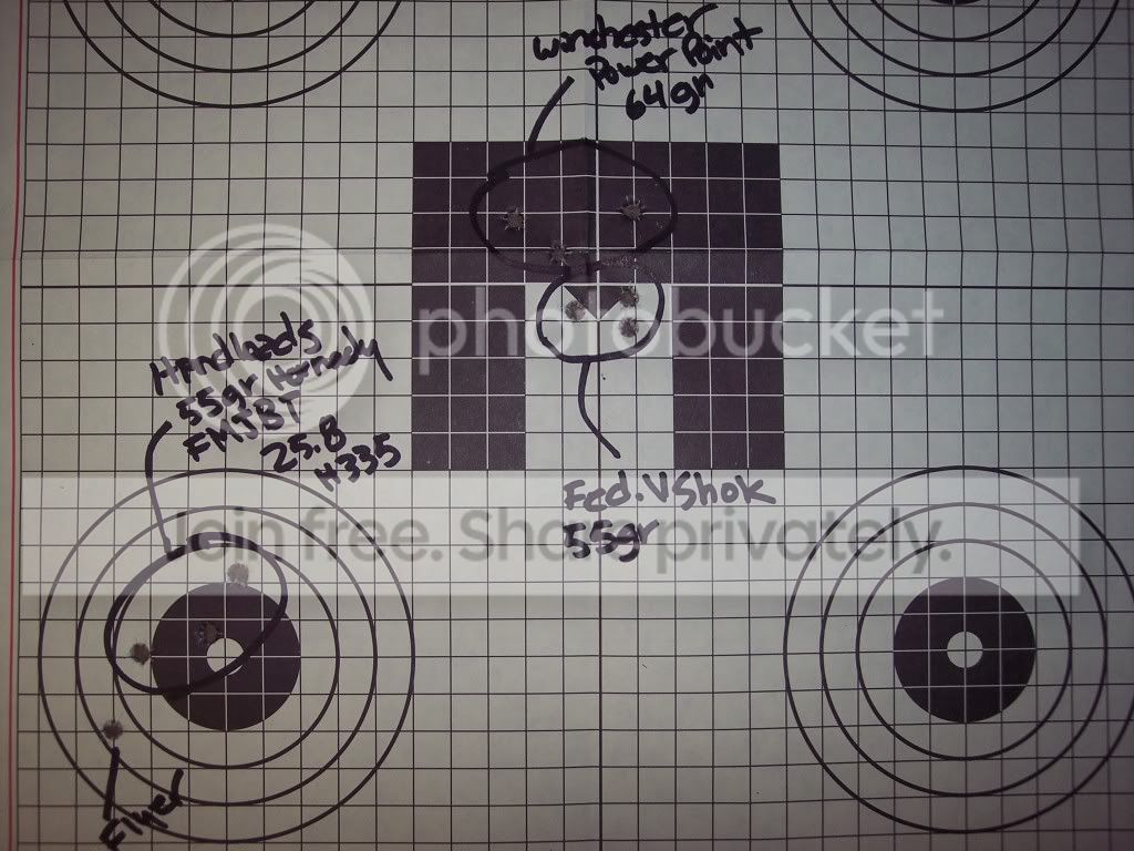

Mega range report, so far so good.
Went out yesterday to test the project. Overall, very satisfied. No system failures or issues of any kind. The gun cycled smoothly. The trigger is very harsh…gritty and heavy. I broke in the barrel cleaning the bore after each shot for ten rounds, then after each 5 round set 3 times. I went for 75 yd zero using 3 different rounds. Fed.Vshok 55gr, Win PowerPoint 64gr, and my Hornady FMJBT 55gr handloads w/ 25.8gr H335. Time was 5:30 PM, overcast, humid, 70-75 temp and no wind shooting off a benchrest. For a first time fire I’m ok with the groupings, I know as the weapon “settles in” and with heavier/longer bullet heads to go with the 1/8 barrel, the groups will tighten. I’m glad I waited/saved for the components I wanted, this rifle can only get “better”.
