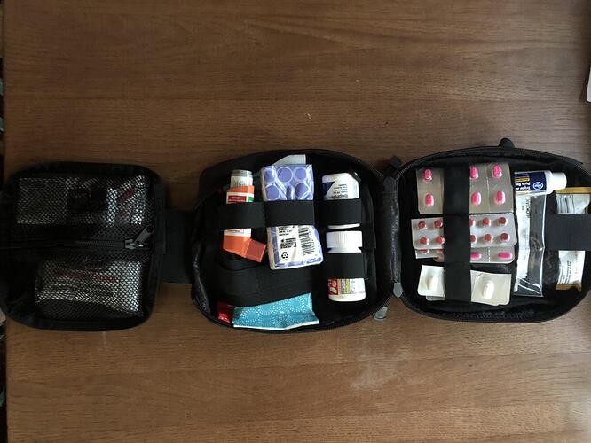

In addition to a well stocked Trauma Kit I’ve assembled the following Medical kit to cover booboos and medical issues that can be addressed with OTC meds.
This isn’t a Trauma kit; that is separate and covers everything beyond Bandaids. It’s built in the same bag as my Trauma kit but is a different color and is obviously tagged differently. Comments? Suggestions? What have I overlooked?
I’m having my wife write up a Pediatric kit with meds appropriate for the Grandkids as they can’t take adult doses.
Here’s what’s currently contained in this kit but in no particular order:

I have a sick call kit next to my trauma kit that I keep similarly loaded out. Besides meds, some stuff I also pack (I’m also in healthcare, so some of the items may not necessarily be of any use for you):

I have all of that in my large Trauma kit except for the OTO scope, but I think I’m ordering a one for my Squad kit. The “dental cream” is Orajel type; added that after a comment on another forum.
I have four levels of kits: a large bin with resupply and for “home” use, a large Squad kit that contains larger stuff and greater quantities, small trauma kits (same bag as these but larger than IFAKs), and now these OTC med kits.
For this type of kit (based on current contents) I would add burn creams and some packs of electrolytes.
Oral electrolytes are a good idea.
Burn cream is a waste of space and money. Simple burns really don’t need anything, and severe partial-thickness/full-thickness, it doesn’t help. Burn dressing, sure. Burn gel, OK, up to you.

Thanks for the feedback; Pedialyte powder are electrolytes so that’s covered. One of the antibiotic ointments is also pain reduction component and can be used for mild burns.

OP… looks like you just raided your local CVS. Personally I’d parce it down, but you don’t really define your mission. Honestly, that just looks like some people’s medicine cabinet - why does it need to be in a kit?

Additional possibilities:
Pepcid…H2 blocker…adjunct to Benadryl for allergic reactions
Vaseline
