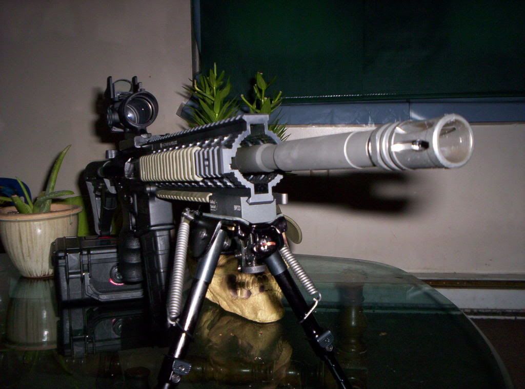

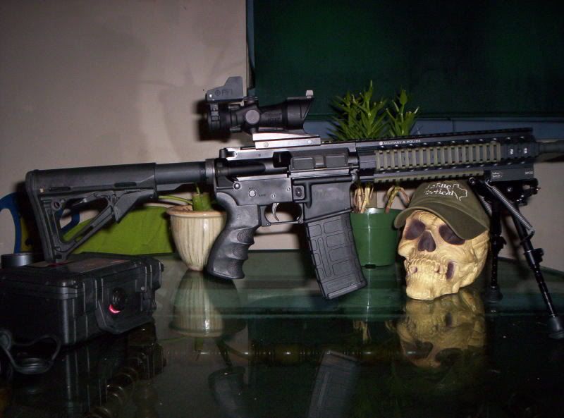

Here’s my “do everything” mid-range DMR carbine… so far it’s decent for CQB, fast for 25 - 50m, extremely wonderful at mid-ranges of 100 - 400m, and decent at long range, 400m+.
http://i261.photobucket.com/albums/ii47/Damascus_747/MP_1a.jpg , http://i261.photobucket.com/albums/ii47/Damascus_747/MP_4.jpg , http://i261.photobucket.com/albums/ii47/Damascus_747/MP_3.jpg
Just a M&P15T with Magpul CTR stock, Pmag, low-profile ladder rail protectors, JP 4lb. tactical springs, LMT H buffer, LaRue 4XDOS ACOG mount (not shown, it’s off right now getting re-finished), ACOG 4x32 TA01NSN w/ Pride Fowler Special Ops Mini-Red dot w/ Pride Fowler ACOG mount, and LaRue bipod adpater… and yeah, the skull is on my kitchen table for my favorite holiday of the year :slight_smile:
P.S. - Kudos to Magpul for including the rubber buttpad with the CTR mil-spec stocks! Before, they only came with the “commercial” size CTR, IIRC?? Saved me from having to spend another $20. I have to say something about this stock, this is the first CTR I’ve really got to mess with up close, and it’s a sweet little unit. I could’ve saved $40 and got the cheaper MOE version, and it still would be a rock-solid fit, but I’m glad I got the regular one, just wish they had OD in stock… but, as soon as I work up the courage, I’m going to attempt to camo this rifle - I hope… But anyways, Kudos Magpul!
