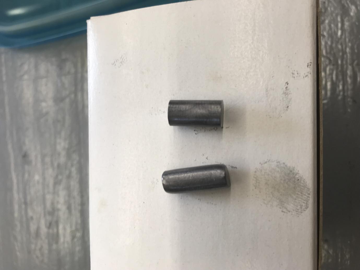

Step One: Core forming
Lead wire is cut to uniform lengths and then swaged into identical cores.
//youtu.be/HsVGW6gir4M
The small wire looking parts at the end are “squirts”, excess lead from the forming process.
Here you can see the cut length of lead wire and the resulting core.

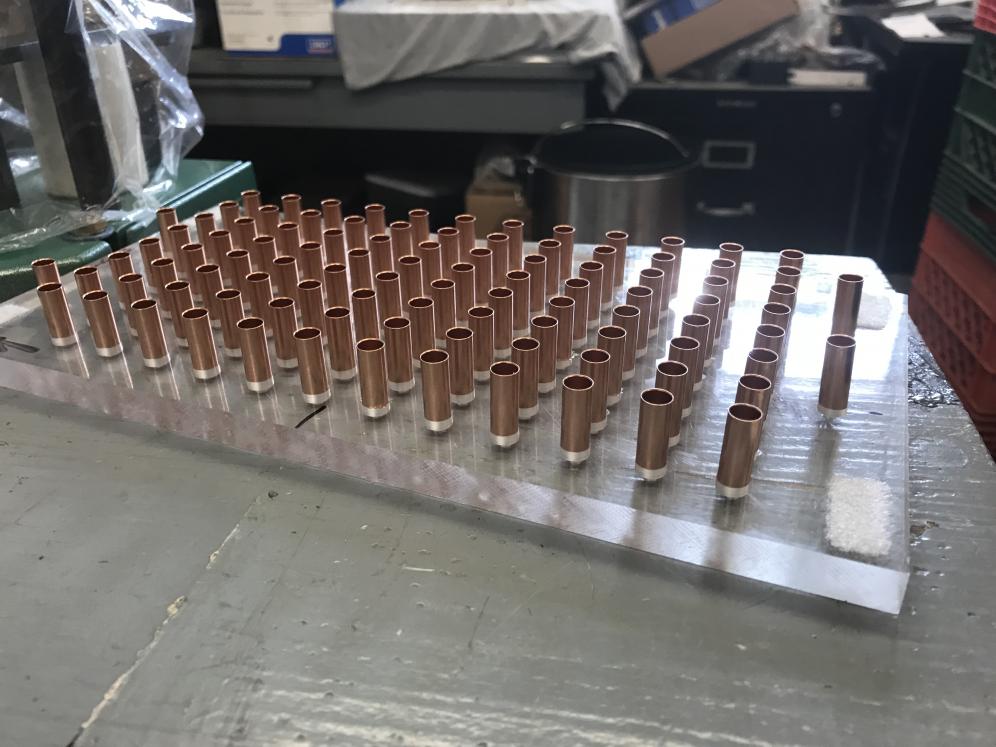

Step Two: Putting the cores and jackets together.
Cores and jackets get washed and lubed and some other stuff, then they are put together using special trays.

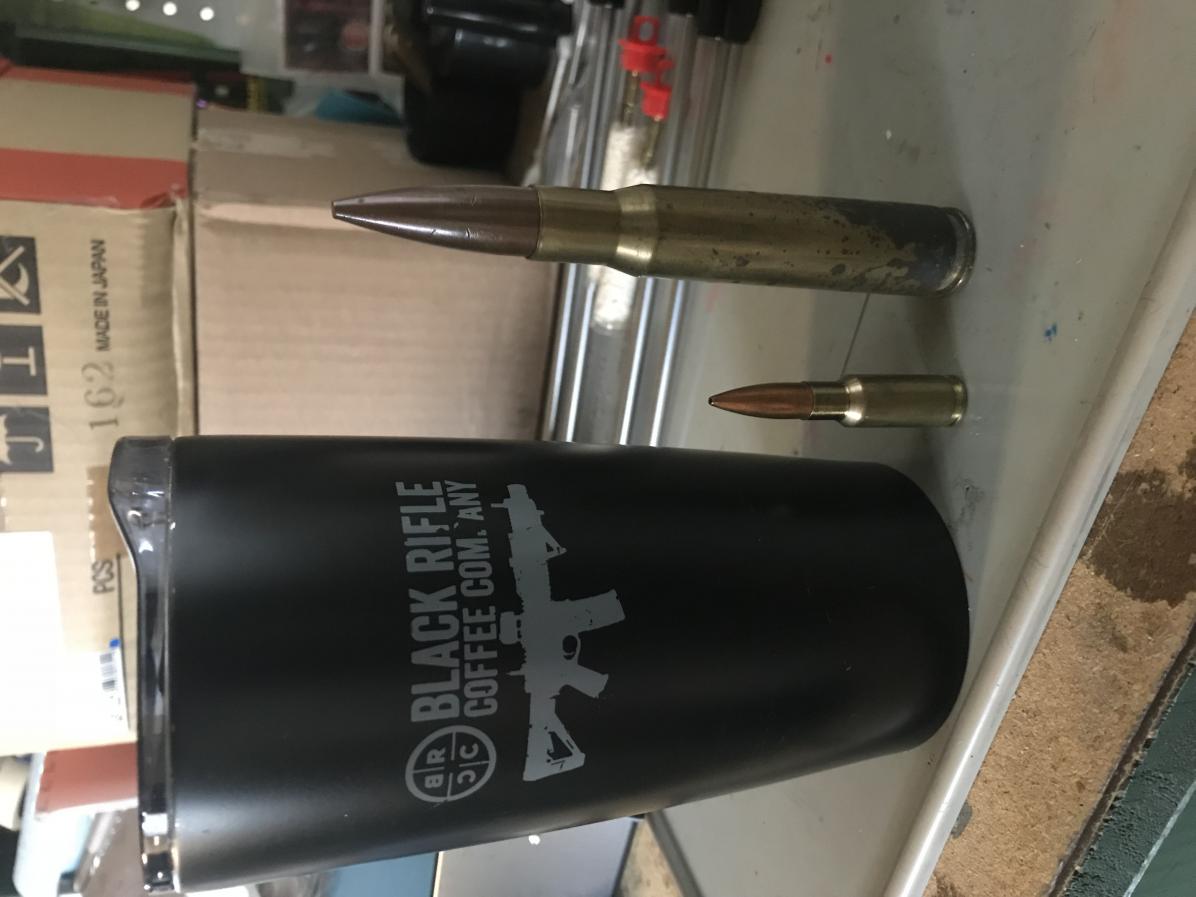

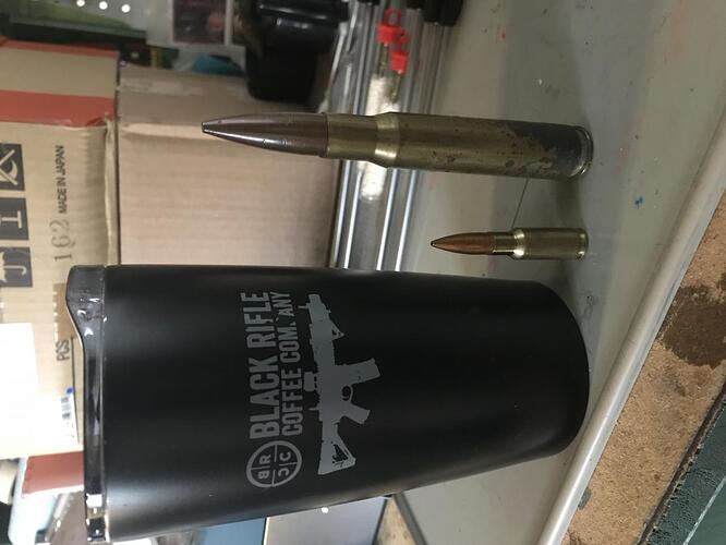

Here is a loaded 30BR, using the bullets I make, compared to a .50!

I don’t know why the photo keeps rotating sideways, sorry all.
