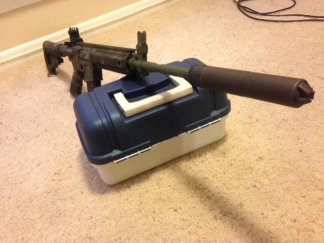

Well, the accuracy has been excellent and the poi shift has been minimal so I didn’t really think too much of it at first. To clarify, I just got the colt back from being cerakoted and they also did the FH. The saker seems to install correctly though, but I don’t want it blowing off the weapon. Bad juju. I’ll email silencerco. I guess I’ll also check to see if it does this on my 300 BLK sbr, if it has been I haven’t noticed it yet.
