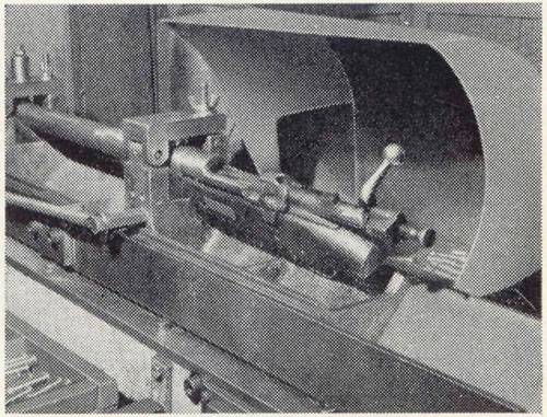

The Crane Naval Surface Warfare Center has done extensive testing with M855A1 fired from AR-15s mounted in a heavy, sliding machine-rest test fixture. The Crane Naval Surface Warfare Center is involved in developing special munitions and weapons for our warfighters. They’re not interested in sales hype and propaganda; they’re only interested in facts. They’re not driven by profit margin; their goal is providing our Special Operating Forces with the best tools for accomplishing their missions. When it comes to evaluating the accuracy of ammunition Crane uses 10-shot groups.
https://www.ar15.com/media/mediaFiles/28568/crane_m855a1_sliding_rail_test_fixture_0-3015847.jpg
With newly barreled upper receiver groups mounted in the heavy sliding machine-rest test fixture, M855A1 was only able to produce a 10-shot group average extreme spread of 2.74” at 100 yards with an average mean radius of 0.85”. With a round count of 3,600 rounds through the barrels, M855A1 was only able to produce 10-shot groups with an average extreme spread of 3.84” at 100 yards with an average mean radius of 1.10”.

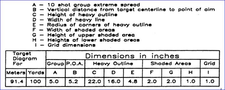

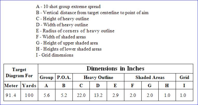

The US mil-spec for the accuracy/precision of the M4 carbine firing legacy M855 from a machine rest allows for an extreme spread of 5.0” for a 10-shot group at 100 yards.
https://www.ar15.com/media/mediaFiles/28568/m4_accuracy_with_m855_002-3172955.jpg
The US mil-spec for the accuracy/precision of the M4 carbine firing M855A1 from a machine rest allows for an extreme spread of 5.6” for a 10-shot group at 100 yards.
https://www.ar15.com/media/mediaFiles/28568/m4_accuracy_with_m855a1_002-3172961.jpg

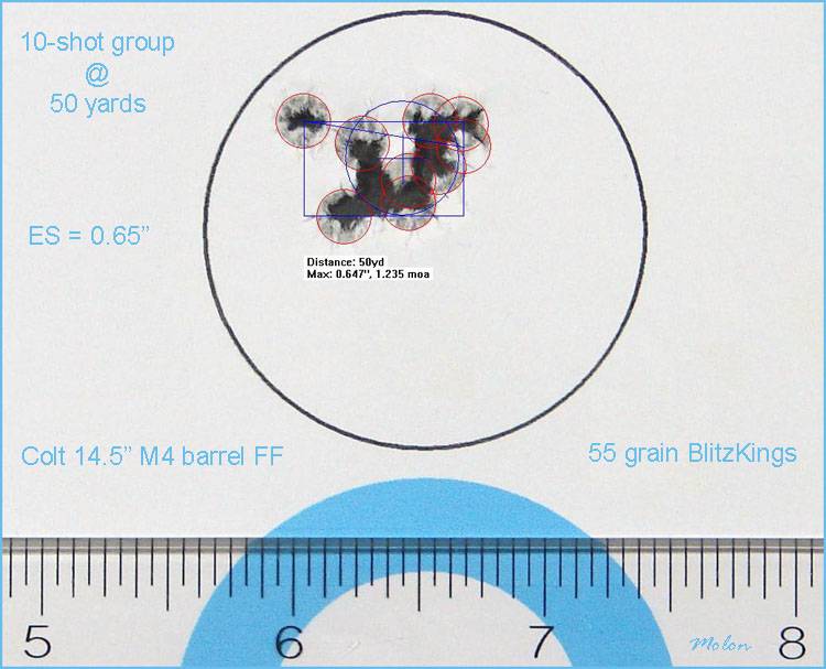

It seems rather odd that the M4 carbine needs to have a larger extreme spread to meet the mil-spec when firing the load that supposedly has “match-like” accuracy. Most of my accuracy evaluation data for Colt M4 carbines was lost in a tragic boating accident, but I was able to obtain a 1.24 MOA 10-shot group from a Colt M4 barrel using true match-grade hand-loads (albeit, this group was only fired from 50 yards).
https://www.ar15.com/media/mediaFiles/28568/colt_m4_barrel_10_shot_group_at_50_yards-3170808.jpg

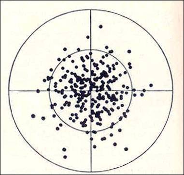

The composite target pictured below shows the twenty-seven, 10-shot acceptance groups (that’s 270 rounds!) of the 1965, M118 National Match ammunition fired from the test barrels at 600 yards. The small circle has a diameter of 6” and the large circle has a diameter of 12”.
https://www.ar15.com/media/mediaFiles/28568/national_match_ammmo_600_yard_composite-3172985.jpg

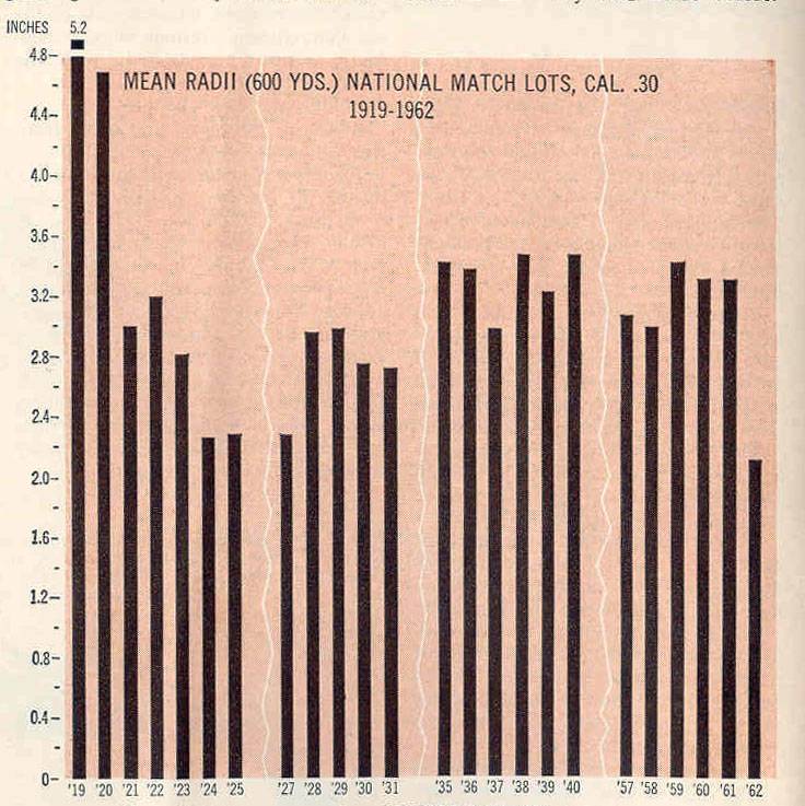

From American Rifleman, September 1965
https://www.ar15.com/media/mediaFiles/28568/mean_radii_history_of_national_match_amm-3172984.jpg
From American Rifleman, August 1962.
Everything else being equal, a mean radius of 1.9” at 600 yards would have a mathematical equivalent of 0.32” at 100 yards. Now, 100 yards is not 600 yards, but then, a semi-automatic AR-15 is not a machine-rested, bolt-actioned, heavy test barrel either, so I like to use the mean radius of 0.32” for three 10-shot groups fired in a row (30-shot composite group) at 100 yards as the threshold for match-grade ammunition in 5.56mm/223 Remington when fired from a semi-automatic AR-15. A mean radius of 0.32” at 100 yards is equivalent to an average extreme spread of 1.025” for 10-shot groups.

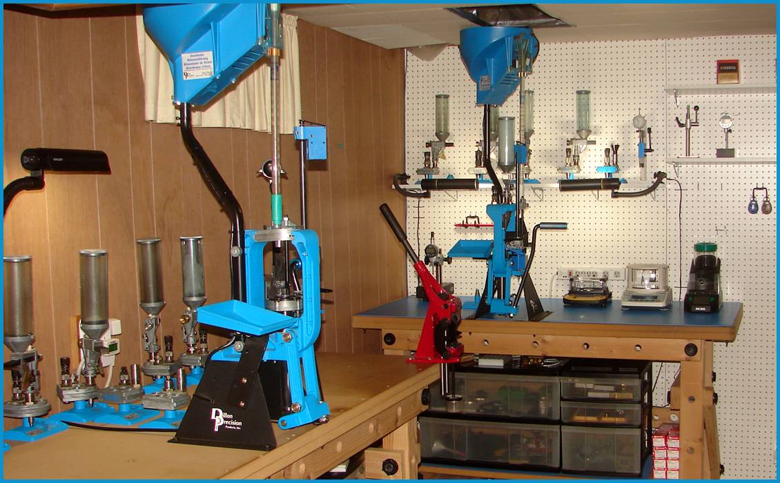

The cases used for these hand-loads were virgin Lake City cases that were weight sorted. The necks of these cases were then chamfered, deburred and neck sized using a bushing neck die. The primer pockets and flash holes were uniformed. Priming was conducted using a Sinclair hand priming tool.
The cases were charged with powder using an RCBS Match Master powder dispenser and the bullets were seated on a single stage Forster press. 10 rounds of each increment of powder charge weights were used to develop a load at 223 Remington velocities. Most 5.56 loads can be hand-loaded to shoot more accurately/precisely when down-loaded to 223 Remington velocities.
https://www.ar15.com/media/mediaFiles/28568/reloading_bench_001b-3173011.jpg

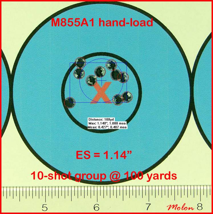

The hand-loads were fired from my bench-rest set-up using the same Lothar Walther barreled precision AR-15 used to test the factory loaded M855A1 and all my usual procedures were followed. The smallest 10-shot group produced in this test had an extreme spread of 1.14” and a mean radius of 0.427” (and a score of 100-10X). Not quite match-grade, but close enough to call it “match-like” I guess.
https://www.ar15.com/media/mediaFiles/28568/m855a1_handload_10_shot_group_at_100_yar-3172298.jpg
