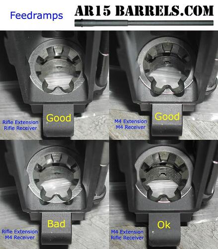

Hey guys, quick question/concern here. This upper I put together is a Spikes “M4” upper reciever with a BCM 11.5" lightweight barrel. I am concerned about the alignment of the feed ramps between the receiver and barrel. The bolt locks up and it seems to feed ok, haven’t taken it to the range yet.
Here is a pic:
Thanks for any advice…
Doesn’t matter. But if you want to ‘fix’ it get a new upper. I can tell by your pic that the upper ramps are cut unevenly by the distances to the bottom of upper.
The M4 ramps in the upper are weak sauce.
This may help?
That won’t cause any issues at all. Shoot it.
