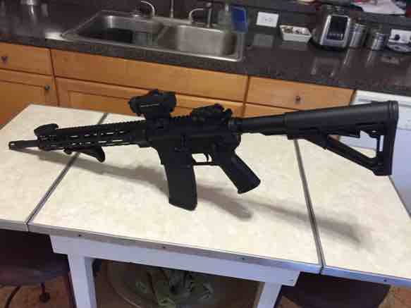

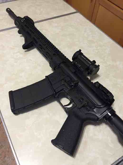

I know you’d rather not have to take it apart but I’d suggest buying the tools, they’re very nice to have around. I agree with others, the new MI looks great. You can fit a 15" handguard on a 16" barrel no problem, although not everyone likes the look. When I replaced carbine length MOE handguard/A2 FSB with MI 12" Gen2SS, lopro gas block, front MBUS, and grip panels I reduced weight significantly. Between that and the longer sight radius you should really enjoy it. You might also try a smaller front sight post, I’ve found that it helps for me.
