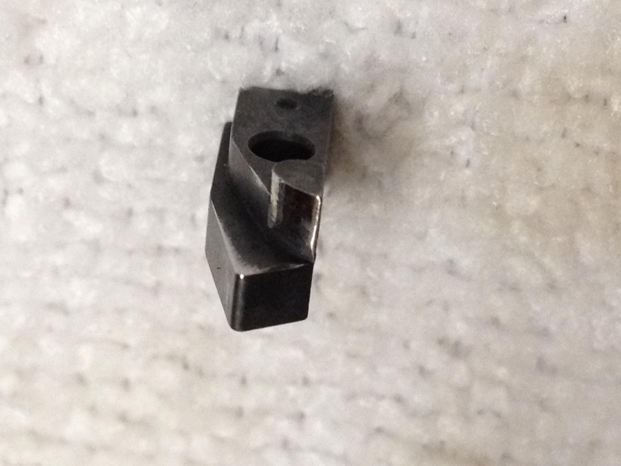

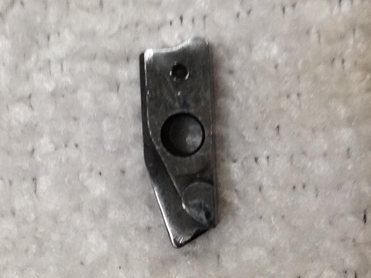

Disassembled and cleaned sear block, dry fire produced same results. Sometimes a few functional trigger pulls, then the same problem. I noticed that the trigger loop/sear engagement is rough.

With the slides removed, the sear and trigger loop engagement is rough. Only the compact’s engagement was rough prior to swapping parts. Both pistols now will not release the striker. Both will release the striker if I pull back slightly on the slide.
Was the compact’s sear damaged, and then damaged both trigger loops?

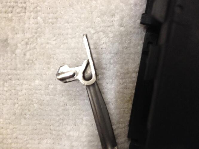

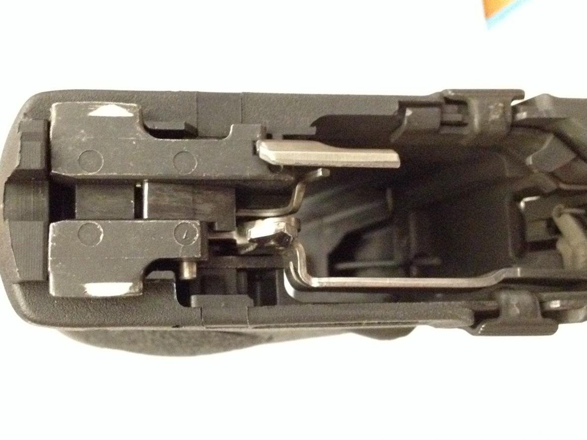

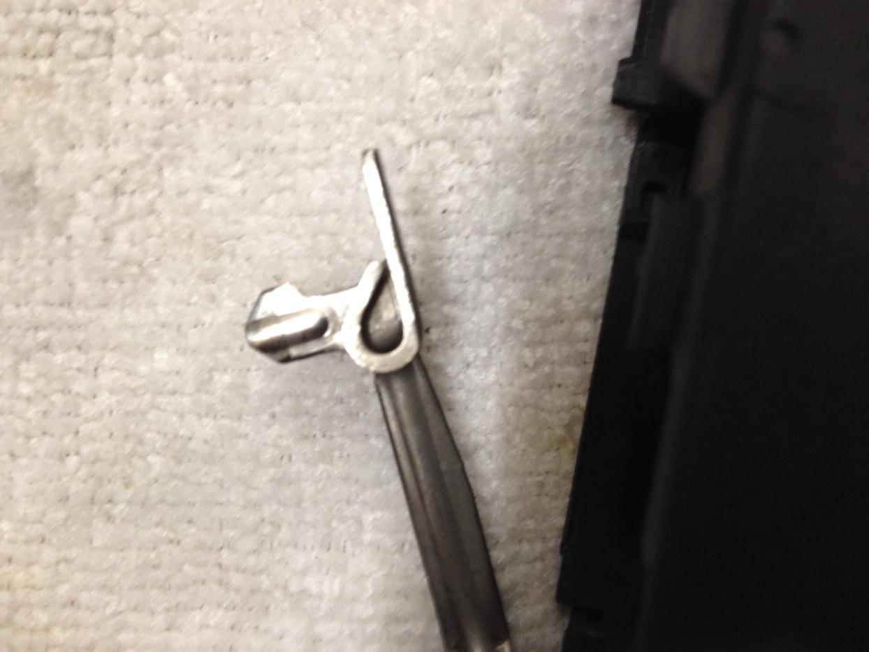

Pics of compact parts prior to my “experiment”
try to bend the loop open just a little at a time until it functions. If u have feeler gauges it would help u know where your at with it. Hope it helps
Since you have been taking it apart, could it be that the trigger bar is too far in towards the sear block? There is a slot cut in the sear block for the tail end of the trigger bar to move with in.

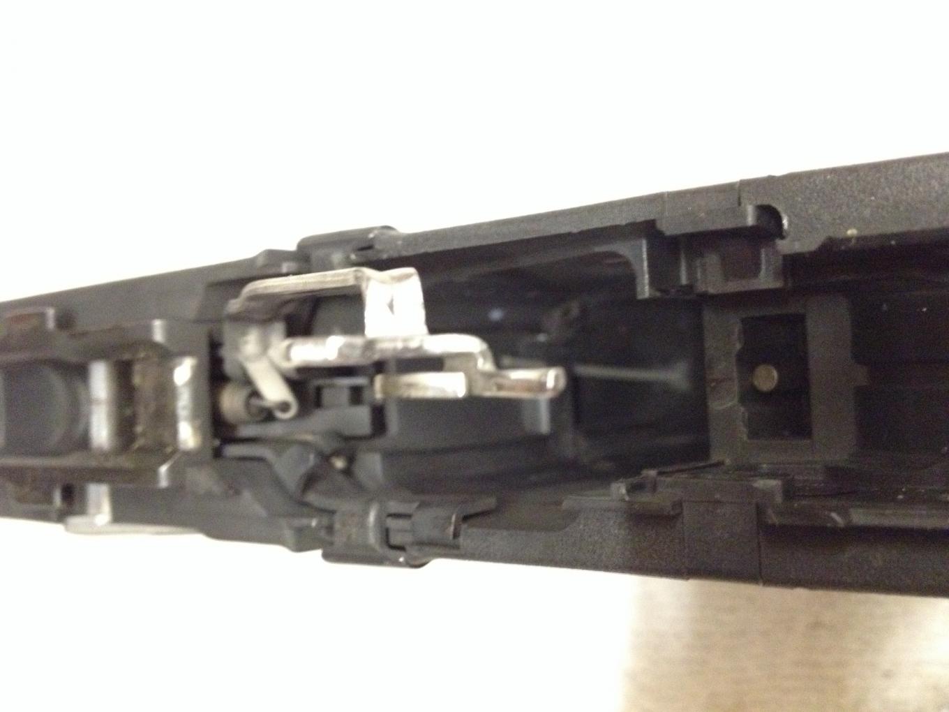

I haven’t gotten a chance to measure tolerances, but I was looking at the photos I took last night. The wear inside the slide from the trigger bar is much heavier than I would expect. This is the compact slide. The full size slide (with 3 times the use) has much less wear than this.
