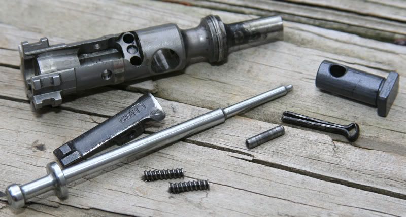

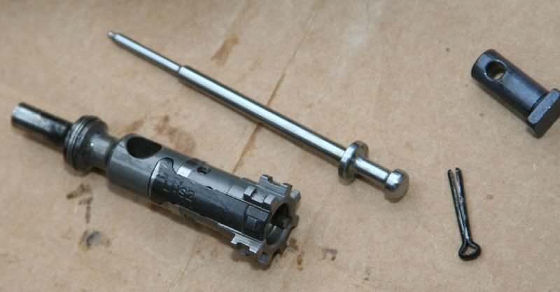

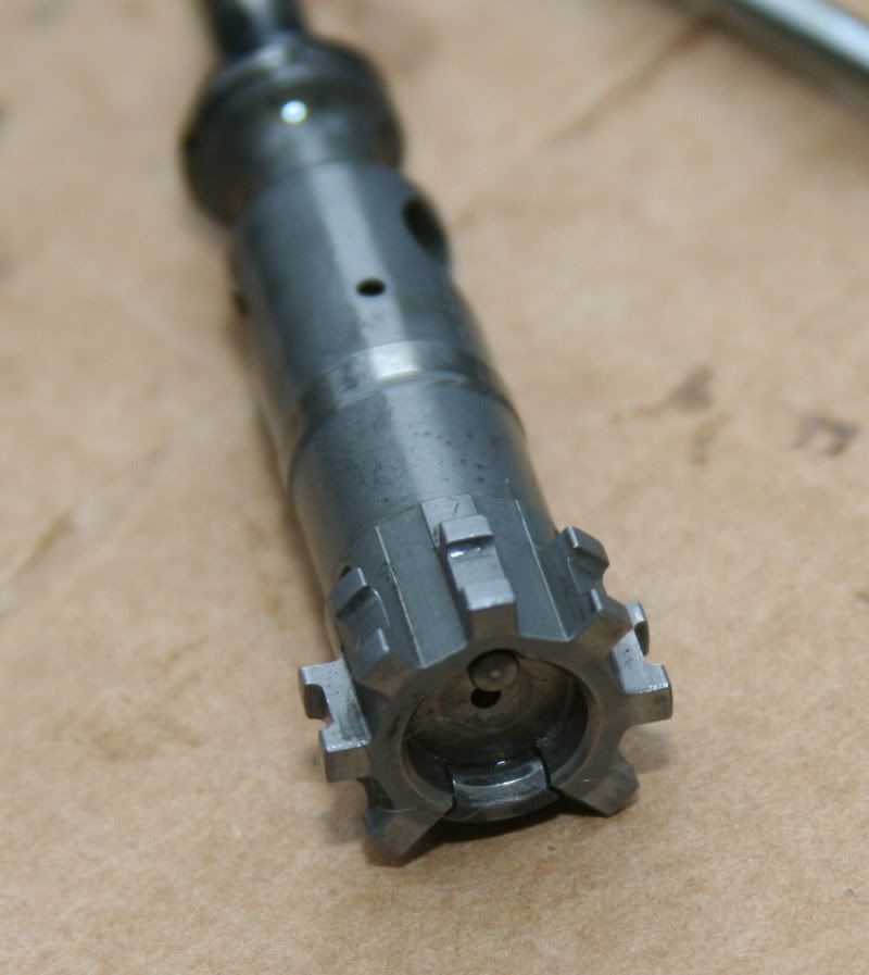

Here’s some pics of the one in my wifes 3gun rifle. I’ve used in another rifle as well. The bolt has 4500 rounds on it. I did wear out the 1st gen. extractor that it originally had. It now has the upgraded gen 2 Raptor extractor which has much more hook to it.
Thanks for the pictures, much more detail than the website pics. I’m going to think it to death, then buy one.
What is the reasoning for the notches / cut-outs on the lugs? Interesting.
(And they are not shown on the website.)
I too am curious to know what the notches cut in the lugs are for. Also what, if anything, makes this better than other bolts?
I’ve had two friends run them in 6.8 DI builds. They seem to produce better groups than the standard bolt. I have no idea why.
I believe they allow the lugs to flex from front edge to back keeping them from cracking. Do they work in the long run? I don’t know, not a ton of rounds though this bolt yet.

The cuts in the bolts lugs are to improve the reliability of the weapon. They allow dirty and sand and such to be move and still allow the bolt to lock into place and you to fire the weapon.
LWRC quit making this bolt.
We are still making the ACB’s, just without the cut-outs in the lugs. The purpose for them was to allow some flex within the lug, to increase service life. Because of the size and locations of the notches some guns experianced feeding issues. In most guns they worked great, but in some they didn’t. Thus the reason we removed them.

The extractor springs look like below, they have black inserts in them:
