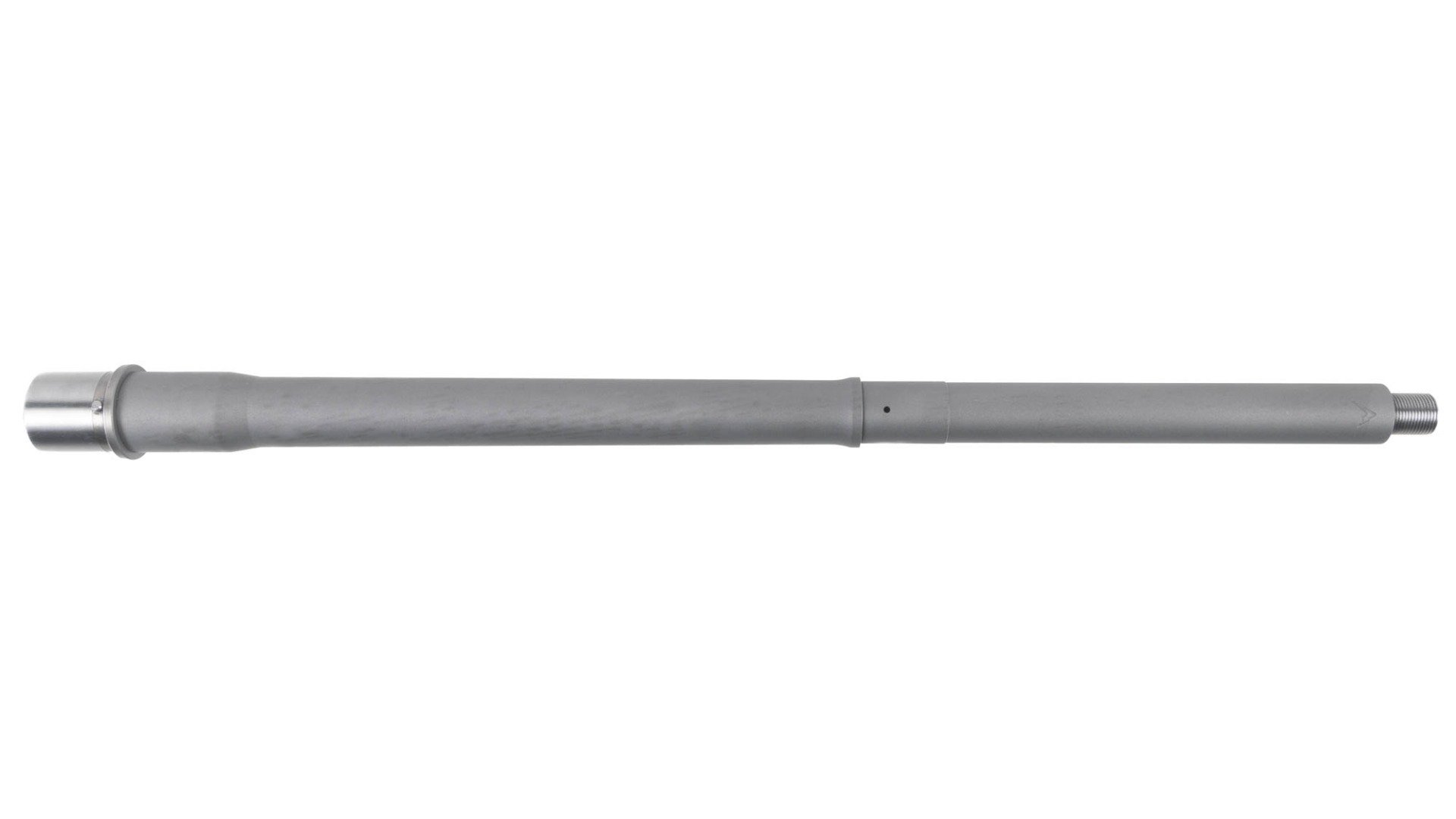

Looking for a new 16-18 inch Precision barrel
Hey guys, I have given up on the skinny Faxon barrel that I have fought and fought to make shoot good. I contacted Faxon to see if they may be able to do something, but if that doesn’t work out I need a new 16-18 inch barrel. What would you guys buy? And where might you buy it?? I just need MOA, but I need MOA.
Shit fire and save the matches, my LMT 10.5 shot a touching group at 50 yards. I feel manufacturing has gotten really good these days, I just need good not great.
Its been a while since I searched for a barrel, so help a brother out.

Yea, I started a thread , Figuring out a new Faxon barrel, but I suck at links and copy and paste to get you there. But you can find it. I have tried and tried to make it work and got a few decent groups but it opens up like crazy most of the time. Ill get a decent group one week, then Im spraying bullets everywhere the next. I know these guys are good guys, so I sent their CS another note. Last time they said “try lighter bullets” and offered nothing. I have shot everything out of the gun and most fodder is 2.5+ MOA, everybody makes an inferior product sometimes but I didn’t get the feel their CS was all about it. Im hoping they can trade me out any barrel, even a heavier profile barrel if needed to get accurate.

I’ve had good luck with Criterion barrels PB. They’re have some affiliation with Krieger.
The two SS/handlapped, then Nitrided, I’m using are both <MOA with IMI 77 gr.- which won’t come close to what you boys are loading.
I’ve seen two Faxon barrels that convince me I wouldn’t buy one.
Pappabear, if you want better than MOA, go to a machinist-gunsmith who will make you the barrel you want from a quality blank. Frank White, John Holliger, and John Scandale are just a few who cater to the National Match crowd.
A mass-produced barrel is just that. Throw raw rods into a hammer forge and you get whatever comes out, based on the quality of the initial bore drill and mandrels. Same with buttoned and broached barrels.
Cut barrels take a while to make, and a gunsmith who custom reams and finishes your chamber co-axial to the bore will more times than not give you a better end product.
I’ve seen a bunch of sub-MOA Larue barrels, including my own. 5+ round groups.
Some friends swear by Proof.
Take a look at Monte’s (centurion arms) recce 16in barrel or his mk12 barrel. Both will give you sub moa 10 round groups with black hills. Also, criterion barrels are also very good.

I agree with Stick, you should chase this down. A 2 MOA precision barrel from Faxon is unsat imo. Has Nathan from Faxon chimed in ?? Usually he will jump in the Faxon discussions…Maybe you can get him involved.
If that doesn’t work out or you decide to try another barrel I could not recommend Ballistic Advantage enough. They also have a mil/LEO discount which makes their barrels even more compelling.
Here are some options. I know you said MOA, but these will give you sub MOA and they guarantee sub MOA. I’ve owned the last barrel on the list, it was a consistent tack driving SOB. I reviewed it with some shot group sizes in the review. BA does guarantee sub MOA performance and they shoot exceptionally well, especially the Hanson profile. I’ve built about 15-20 AR’s with their barrels and I have yet to have an issue with performance or finish.

Ballistic advantage Hanson would be my pick on the value end. I would also look into:
Larue Predator or stealth barrels
White oak
Keystone Accuracy
Compass Lake
They all make high quality match grade barrels and would probably work for you if you are willing to compromise on the pencil profile. Even BA has an MOA guarantee.
I have a 18" Stealth and it is a MOA barrel…not necessarily with me pulling the trigger, but the barrel is capable at 100 yards…mine likes Black Hills 77gr TMK and Hornady 75 gr OTM…If I was rolling my own, it might shoot tighter
https://www.larue.com/products/5-56-stealth-barrel-k/
I’m not a marksman by any means, but I can say that of the four barrels I currently shoot (BCM gov’t 12.5, BA Hanson 11.5, Colt CCU 16”), the Black River Tactical SPR 16” shoots the best for me. Someone else would have to chime in about MOA, because I’m not there myself with anything yet. But it is accurate, and it is soft-shooting.
http://www.blackrivertactical.com/concrete5/optimum-barrel/#!/BRT-16-OPTIMUM-SPR-STAINLESS-Barrel-5-56-MOD0/p/113782749/category=1852006
My only direct experience in precision barrels is with a white oak SDM. It would meet your requirements. I think anything from white oak would really. I have BCM, Sionics, Faxon and BRT barrels but I’ve not seriously shot them for groups except the BCM standard govt. which has been surprisingly accurate.
You didn’t say if you wanted stainless, chrome or melonite. If stainless wasnt a requirement then I’d say try a Criterion Hybrid. It will be my next barrel. I’m interested due to their accuracy claims and anecdotal evidence backing them up but without giving up the durability of chrome lining. Sounds like a perfect barrel if true.
Don’t forget about Sionics, down the road. I have one of their 16” medium-contour barrels that is consistently MOA-ish with 77 gr. CBC. I think you should easily see MOA of one, the way you (Mark) roll your own with 77 gr. SMK’s.
I’ve been very happy with my 16” BCM 410 SS. Sub-MOA 10-shot groups at 100 yards. When/if it is replaced it will be with a 18” Compass Lake Bartlein blank/CLE chamber for the incremental gain in velocity and, most likely, accuracy.
