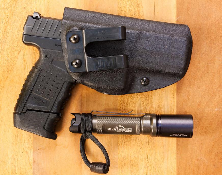

WS6, I don’t disagree that SF remains the undisputed leader in quality WMLs. But as an admitted fan of Malkoff products, I very much prefer supporting a small “mom & pop” American business that has always operated with the highest ethics and unmatched customer service. That said, my favorite hand held is a 1000-lumen Malkoff/SF Lego;

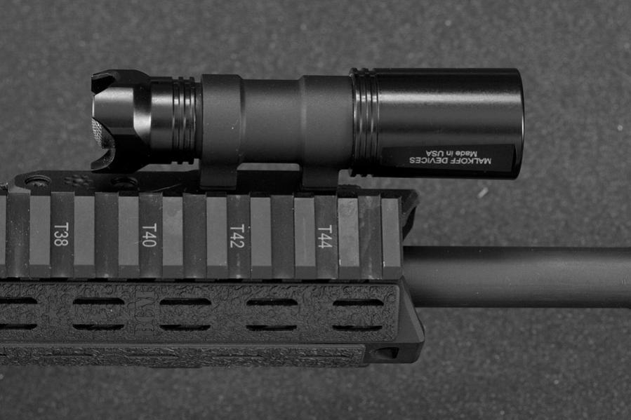

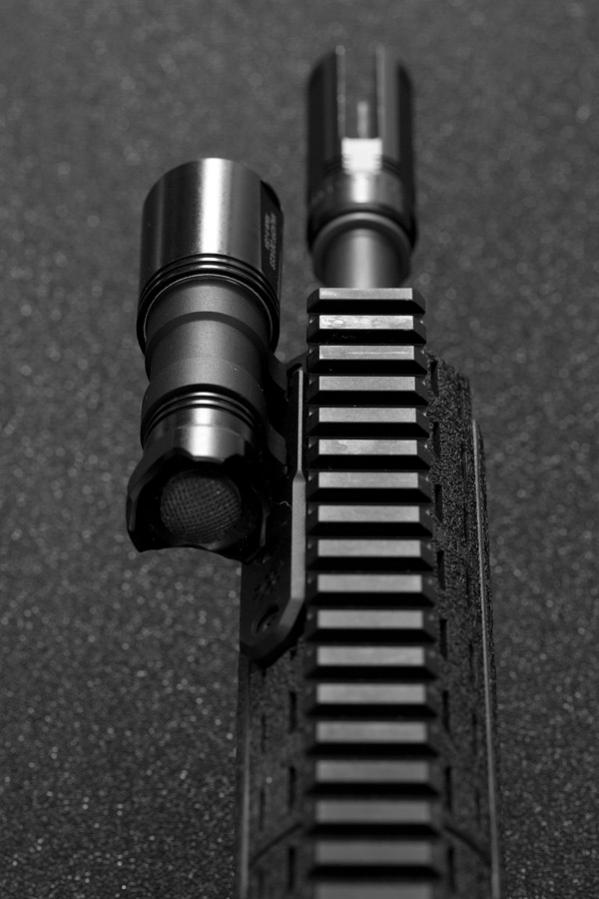

I have installed the new light set up, which comes in at 3.4 ounces including the 16340 Li-ion cell. I ended up using a Malkoff E-series Tailcap because I had one on-hand. Along with using a readily available (and easily replaceable) McClicky switch mechanism, it also provided an unexpected benefit: due to the deep scallops, the ability to turn the tailcap with just the thumb. Turning the tailcap about 120 degrees CCW locks-out the light, turning it back with just the thumb (with the support hand in its normal firing position) re-establishes the connection.
I’m pleased with the set-up. It’s compact, lightweight and snag-free, with the ability to fit a wide selection of Malkoff MDC or SF E-series heads. I currently have a Malkoff Bodyguard v.1 head installed, which provides 700 lumens on a 16340 Li-ion cell or 400 lumens on a standard CR123A lithium battery. It’s an easy swap to install the 1000-lumen v.2 head, which currently resides on my hand-held shown above.
