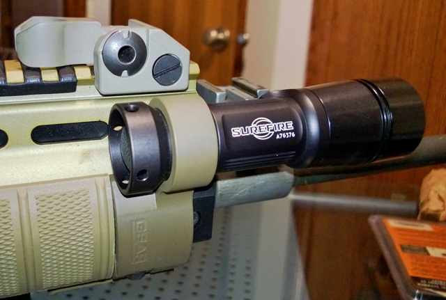

Gear Sector offset mount for the surefire mini-scout:
Barely clears the front sling loop.
You can still adjust the front sight windage with it on. Flipping up the front sight isn’t too bad if you stick your thumb in there from the front.
Flipping it down is a little tougher, especially if you have bigger fingers.
But who needs speed when flipping down sights? :jester:
Edit: Gear Sector, not gear logo lol
Gear Sector mount with Scout tailcap, E1B body, and Malkoff VME head (230 lumens)
Agree wish I had done more research and got the PWS drop rail.
