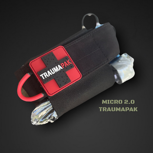

Just adding as an option as I just ordered one of their kits for our new issued external carriers.
High Threat Innovations
LE Discount of 20%
I personally went with the Micro 2.0 TraumaPAK ELITE with the QuikClot option.
*Micro TraumaPAK ELITE (With QuikClot)
1 Micro 2.0 TraumaPAK ELITE Holder in your color choice
1 Tourniquet (Choose from CAT, SAM-XT, SOF-T)
2 Hyfin Vented Chest Seal
1 Battle Wrap or SWAT-T (Orange or Black your choice)
1 QuiKClot rolled gauze
1 Trauma Shears
1 Pair of medical gloves
1 Sharpie
1 SAVE a life card
Your choice of patch*
Hmm not really sold on these saran wrap or rubberized style pressure bandages, Id probably swap it out for an Israeli or another type of stretchy trauma dressing. Way more versatile especially with the limited space on a belt kit.
SWAT Doc didn’t object but… like you, I felt an Israeli may be better and snagged one to replace the Saran Wrap with.
As a pressure bandage the SWAT-T works well. Anecdotally at least as well as the Israeli.
