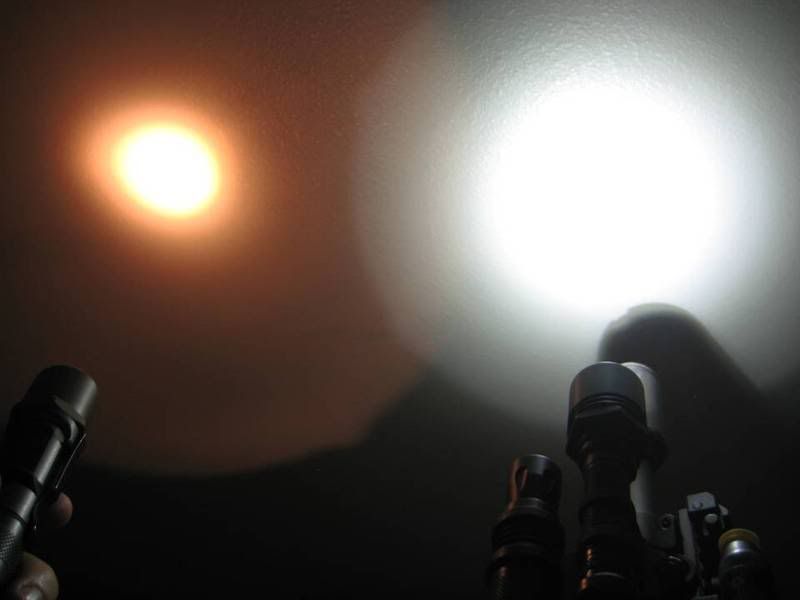

Instead of running a Scout, I run a E2D body with a LU60A conversion…inside the conversion is a Malkoff devices P60 Drop in Module.
I have been working with Gene now for a few months and his drop ins are pretty amazing! I have been running extensive and honestly pretty damn rough testing and all is good… my son has even played baseball with the light.
http://malkoffdevices.com
His drop ins are only $55 and $78 for the LU60A coversion kit $110 for E2D. So either spend a wopping $243 or if you have a E2D/E2E body layin around its a great build!
Or the cheap route is a G2 nirtolon $36 and $55 drop in and you have yourself an el cheapO torch!
He is building newer and smaller ones for E2D heads but it is a work in progress. He will be a SHOT this year so feel free to pic his brain.
You can drop this in any 6P style head up to a 9v system (Awsome run time 5.5hrs)
This scout version runs at 230 lumens for 3.5 hours
This is a standard 6P C2 Centurion next to it…
