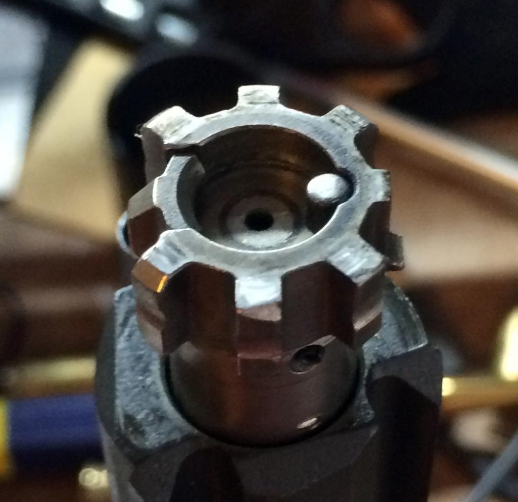

I had a bolt chip on a lug ~2000rds. It took awhile but they replaced it. I have yet to shoot the new one.
Pic of bolt:
I was surprised about the chrome carrier key as well, considering mine from 2017 is not chrome lined. It’s good to see LMT make that change. For what its worth, the 2017 version I have had the correct carrier key screws and were not rounded. I ended up swapping mine for a chromed gas key and Neds Optimized Carrier Key Screws.
You may be the first person to ever break an enhanced bolt. At least you’re the only one that I know of. Did they give you any indication as to why it broke?
