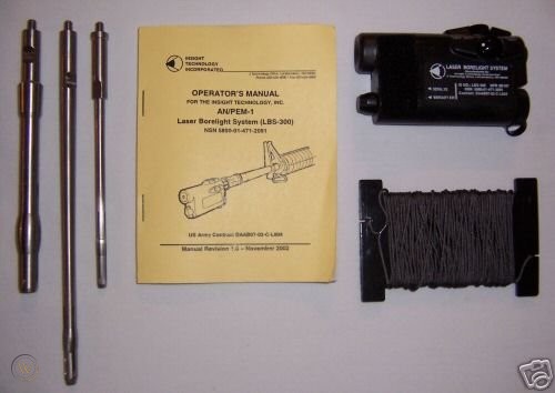

I can’t speak for all of them, but the LBS-300C (AN/PEM-1) works great for all my military clones. Gets me on paper & pretty damn close to where I need to be.
I learned to use this in the military, and even though I had to make my own targets based on those in the manual, it was pretty straight forward & simple.
It has a 1mw red laser, so actually works better under cloudy/dimmer conditions, but even in full sun is visible out to about 100yds (with magnified scope use)
I mostly use it to get a base zero for my A4 clones on 25 meter targets, but as stated above, you still have to confirm at 300m with actual zeroing shots/targets.

Muzzle… definitely. They are just all around better, though usually more expensive, however there are numerous benefits to the muzzle ones:
They are almost always more accurate.
It’s far easier to make adjustments to the beam/unit.
They usually have easily replaced mandrels for use with different calibers.
There is no need to disassemble components from the weapon in order to use it (other than sound suppressors).
And… Most of the military oses even have a dry-fire mode that allows you practice your shots with the help of an assistant who sits by the target & marks the point where the laser “blips” each time you drop the hammer.

Here is a rather decent article from RECOIL which I think does a great job covering this topic (various types of bore sights) which I think is probably best to help the OP make up his mind as to how to go, however, the article doesn’t cover the military model (AN/PEM-1) which I previously mentioned. & just for reference, usually runs between $75-@$250 off Egay so keep that in mind as even though the LBS-300 uses a visible red laser - it runs off a standard AA battery, and is still an outstanding muzzle bore sight system.
