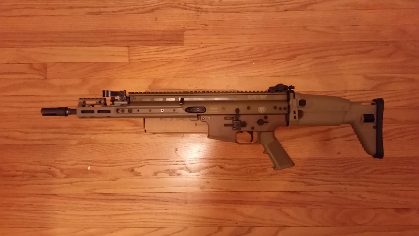

Here is mine:
I too chose to remove the factory bridge rather than tinker with my flash hider. So far, I’m pleased as this rail does a great job of removing the ATPIAL from the sight picture since the 12 o’clock rail extension is an inch or so lower than the SCAR’s top rail. I will say that having an illuminator that far forward makes the gun nose heavy - especially without the PVS-14 attached. I would be hesitant to go with a DBAL which is even heavier. I’m going to take it to the range next weekend and see how the balance feels shooting with the ATPIAL + suppressor +/- PVS-14.

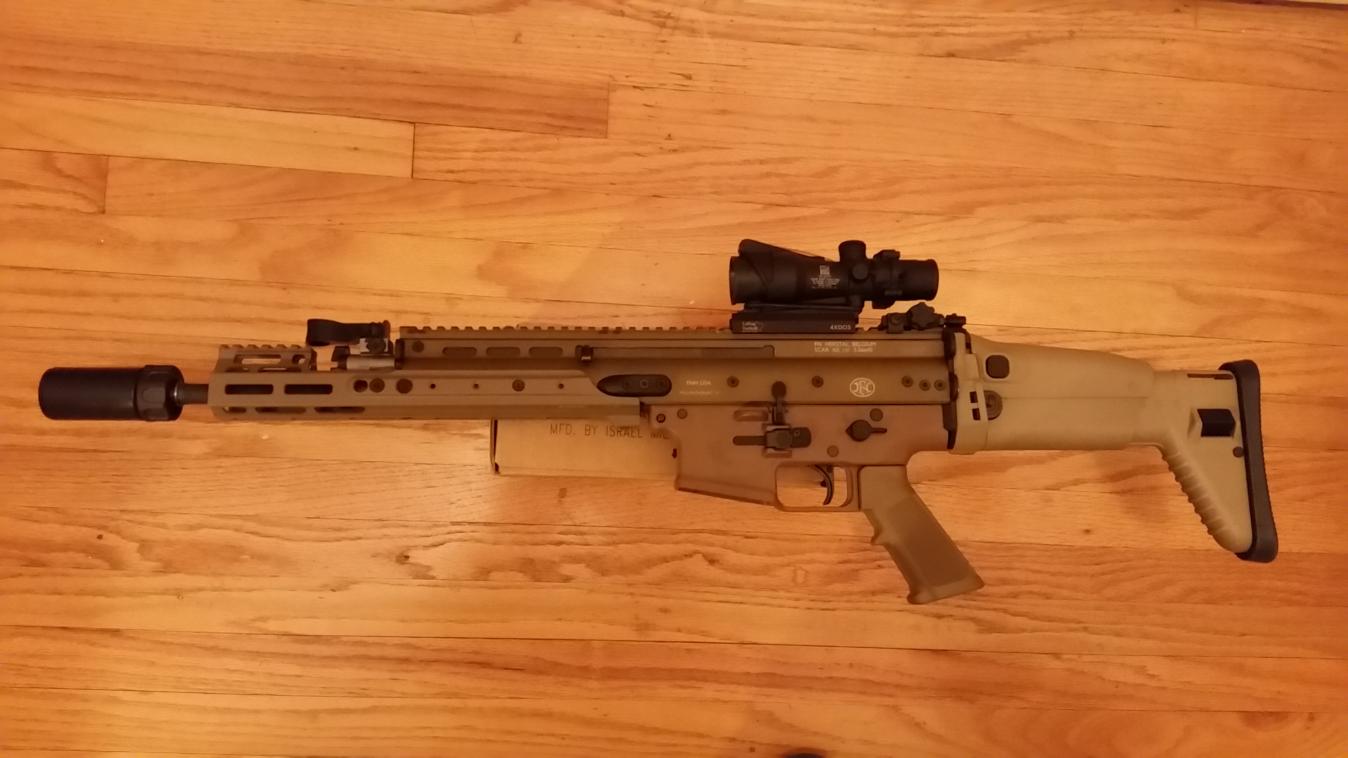

Here are a couple more pictures with the MLOK rail / VFG pushed forward a bit as well as a top down look at the rail.
Thanks rhinowso, awesome write up.
Sounds like KDG has gotten some requests for an MREX rail solution for 10" SCAR 16s, which in my opinion is great news.
I assume that the purpose of such a rail would be to simply convert the rifle to an M-lok system without adding much if any length.
Actually if you look at the bottom rail on the 16 (OEM) and the KDG rail on the 17, you can see that the overall profile is slimmer with the KDG rail.
