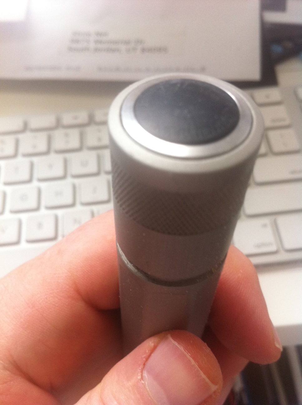

My iPhone 4 can focus close in. I just took a test picture of a knurled end of a flashlight held 2-3 inches from the iphone and it was mostly clear (finger in the picture is an extra inch or two away). You need good light and you need to touch the screen and tell the phone where to focus. I was able to clearly see the knurls in the end of the light when taken. (Sometimes you need to touch the phone screen to tell it where to focus a few times to have it retry and you need decent light – I had overcast rainy sunlight coming in a window for this. Sometimes you need to shift position)
Taken with iPhone 4 with flashlight and finger ranging from 2-5 inches from phone as a quick test. Saved as jpeg on my computer with about 75% level
That’s pretty impressive. I’ve still got the iPhone 3G from 3-4 years ago. I’ll try to test out the method you described above with it. Thanks for sharing the info.
