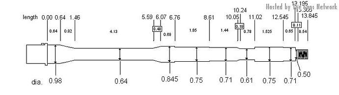

I found a dimensional drawing online that claims that it is really only 13.85". I know sometimes things can be “nominal” or “proximal”, and so forth.
Is an M4 barrel really actually truly 14.5" long?

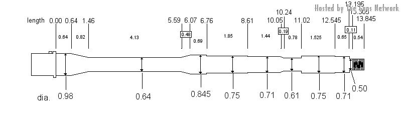

It is when you include the barrel extension.
I believe the ATF measures from the closed bolt face.

Correct.
First, that is not the drawing that M4 barrels are made with…
Second, you failed to add the portion of the barrel that the extension threads over. So that adds .620 to the length.

True, but the “nameplate” length is generally measured from the breech face.

There was a thread a while ago about this.
A lot are near 14.5 but most were a bit longer.
Yes, that’s right the ATF measures from the closed breech face.
So then, from the closed breech face what is the length of an M4 barrel without a muzzle device?
This could be an important detail for people when doing a pin and weld muzzle device.
TED
The ATF procedure for measuring barrel length is to measure from the closed bolt (or breech-face) to the furthermost end of the barrel or permanently attached muzzle device. Permanent methods of attachment include full-fusion gas or electric steel-seam welding, high-temperature (1100°F) silver soldering, or blind pinning with the pin head welded over. Barrels are measured by inserting a dowel rod
into the barrel until the rod stops against the bolt or breech-face. The rod is then marked at the furthermost end of the barrel or permanently attached muzzle device, withdrawn from the barrel, and measured.
