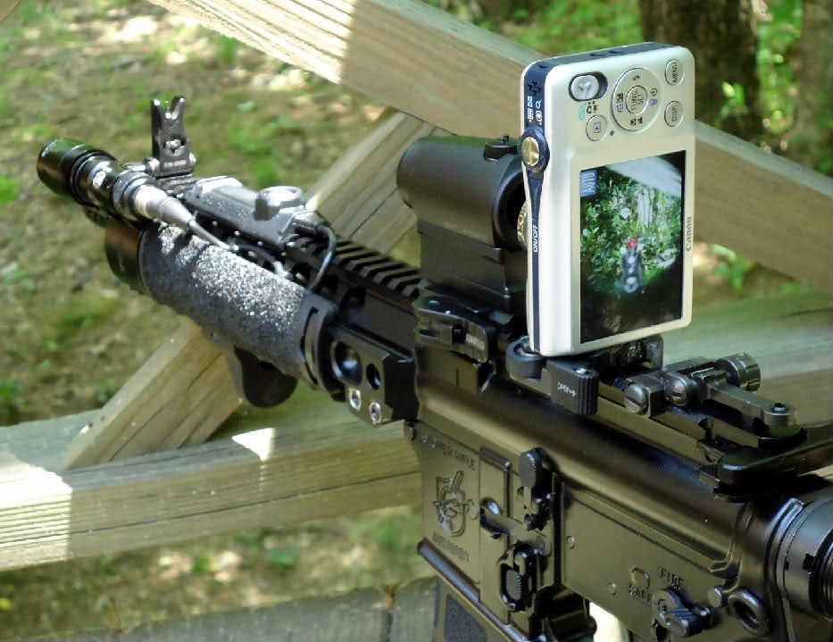

Here is a video I made a long time ago of a 4MOA dot on the T-1 and a cam as a magnifier…shows what Euro is talking about.
//youtu.be/G6E7vBXhf3Q

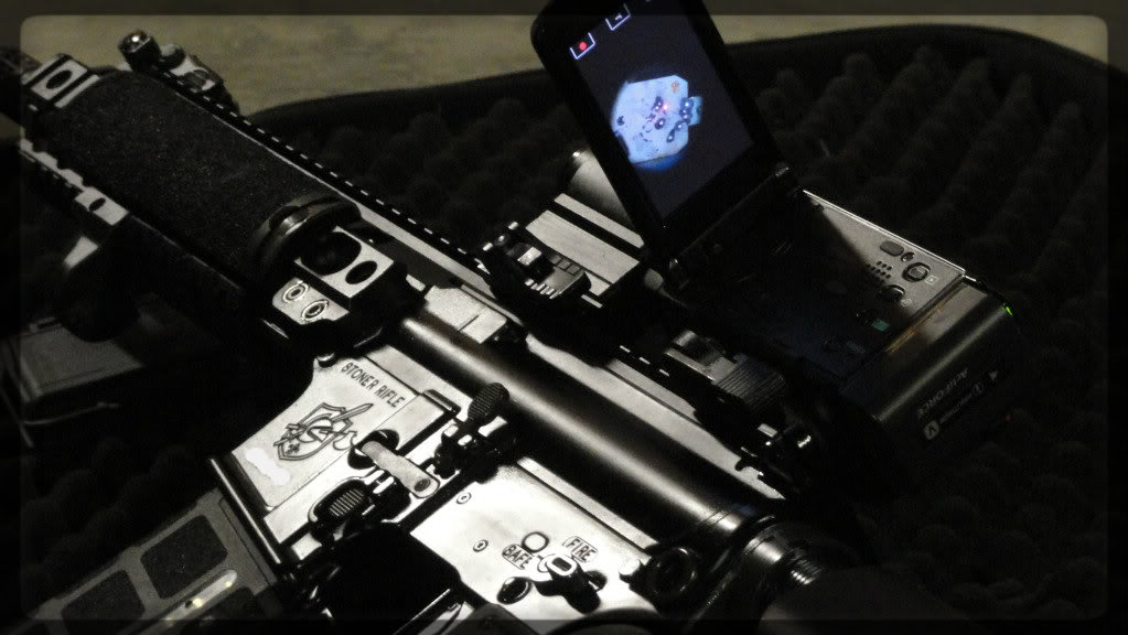

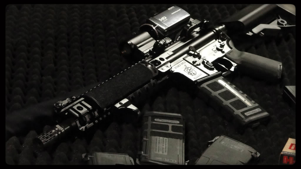

Here is my first attempt at “Aimpoint Vision”, and IIrc the cam I was using only had 10x.
//youtu.be/cMjB6jYLaCo
It’s FFP and remains a 3moa dot.

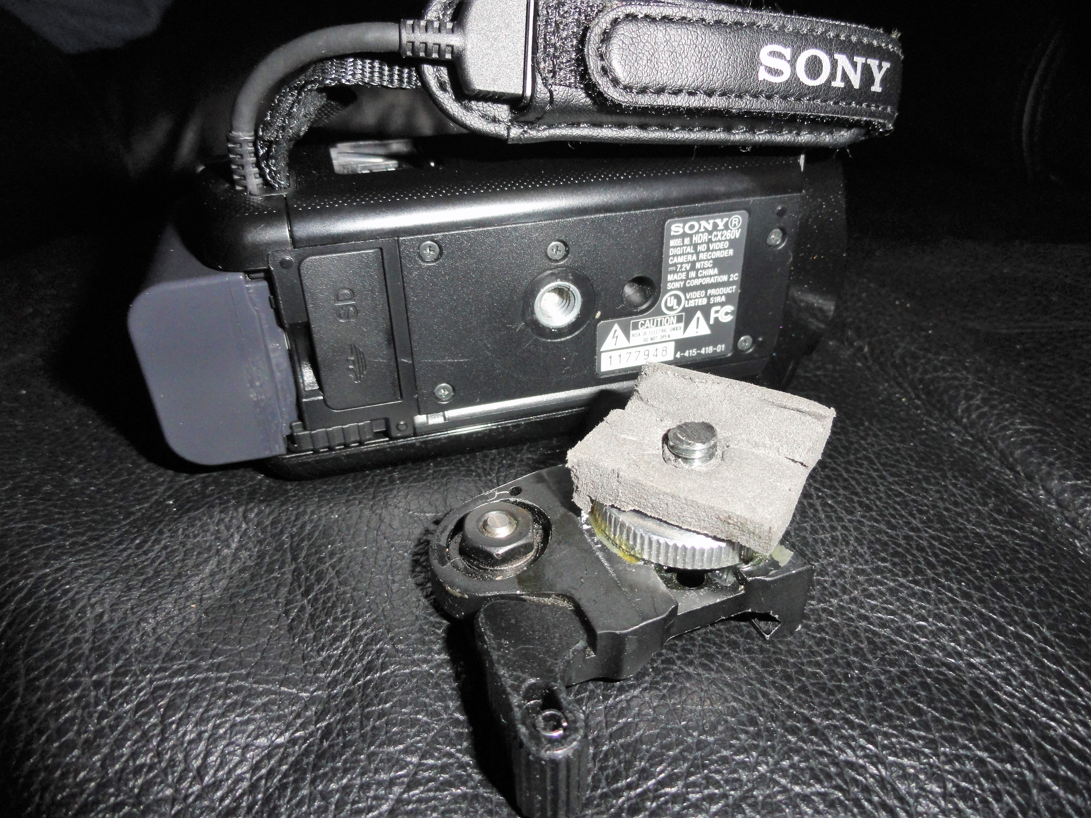

I love those videos. Care to share the setup?
Appreciate it. I just bubba things up, and the last video…or first one was this setup:
Second video was with this setup…
All of them shared this same bubba’d mount made from a larue with a epoxy base that features a screw that is common to most cam tripod holes. Put a piece of stiff foam to dampen the recoil vibration on the quality of the video. This was years ago, and I’m sure now somebody could create a much more elegant and effective solution.
ETA: I just remembered, and looked at that pic again of the first setup…I tried to epoxy a cheaper cam or the one in the pic straight onto the Larue base mount, but after a mag or two it snapped the plastic or something. When I used the epoxy screw mount as shown in big pic…things never broke, but still hard to lock the camera down from rotating after a few rounds due to recoil. Vibratite would do wonders though I’m sure.
