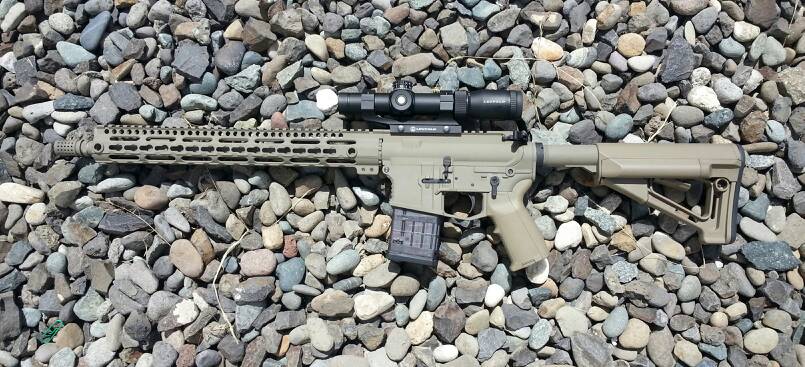

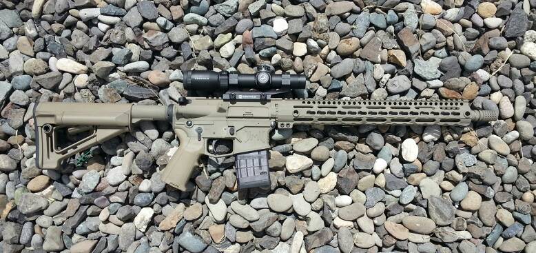

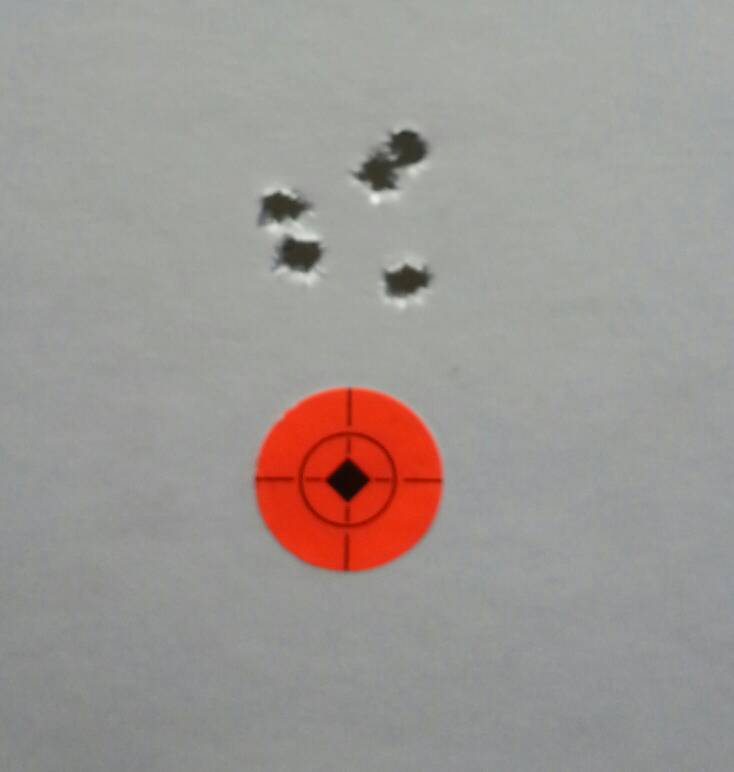

I shot my inter-mid rifle build today super soft with vltor a5 I used the 5.3oz buffer. Easily under 1 moa.The scope is a VXR 1.25-4 firedot not exactly a precision rifle optic.
