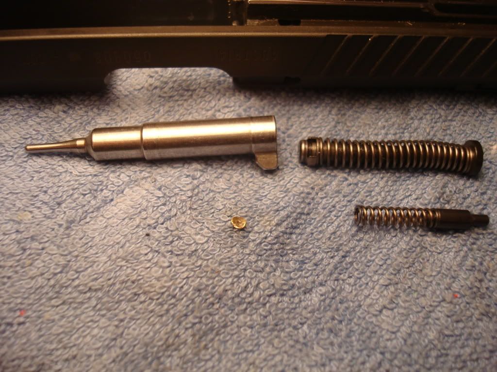

A while ago I had a 9x19mm Tulammo round fail by what appeared to be overpressure in my Steyr M9A1. The primer cover blew off and the case became lodged in the barrel. The pistol was undamaged, and I was able to dislodge the case at home.
After removing the case, I ran 100 rounds through the gun without issue. A week after that I went to the range again and had sporadic failures to fire. The primers were untouched, and I was pretty stumped as to what was going on. I took the slide apart, and a brass price fell out of the firing pin/striker channel. I guess that when the primer failed, the cover was forced into the firing pin hole, and eventually was obstructing the striker.
It never occurred to me that this kinda thing would happen, and found it particularly surprising it didn’t start effecting the pistol until after 100 rounds in, so I thought it might be informative. Any one else have something like this happen?

With that piece of brass in your striker channel, it may have wedged itself into a corner just behind the breech face, where the striker wasn’t impacting it or anything, then all of the sudden decided to come free and cause an obstruction. While that kind of thing isn’t completely unheard of, my guess is that it’s not very common.
It wasn’t just a piece of brass, that builds up all the time with no effect, it was the actual primer cover. See below.
Tulammo would be below average pressure from my experience. I know for certain the round failed do to over pressure, as there was a blight flash from the ejection port and the casing became lodged in the barrel. I am more curious as to the way the berdan primer cover was forced through the firing pin hole. That was just something I never thought would happen.
It’s always a good idea to detail strip the gun, clean it, and inspect it for damage after a catastrophic failure like that. Modern designs and metallurgy are miraculous, but not fail-safe. Unseen damage could cause another even worse failure if you keep shooting, and that could be the failure that ends your shooting career–or your life.
