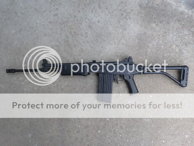

Dave is correct. The natural motion to take it off safe is to move it forward…which is how the US civilian Magnum Research and Action Arms Galil’s worked.
The military Galil operates in reverse, forward is safe and back is fire, and it’s not natural at all, and is in fact a pain in my ass.
I’ve had several semi auto Galil’s through the last couple of decades and never had an issue with the selector…
Action Arms/IMI Model 329 AR in 7.62 NATO:
Magnum Research pre-86 dealer sample SAR in 5.56 NATO:
